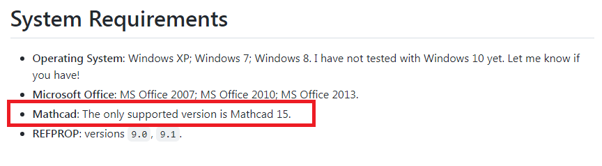

1. Have you used this version of REFPROP? Link: https://github.com/nagimov/refprop2mathcad
