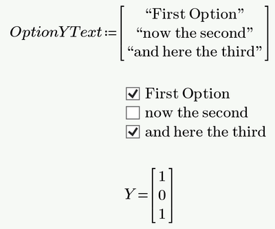

It should be trivial and it may be convenient, but check boxes in Prime are only isolated.
But you can assign the output to vector elements and so have all values available in one variable if that's needed.
You may also hide the left hand sides

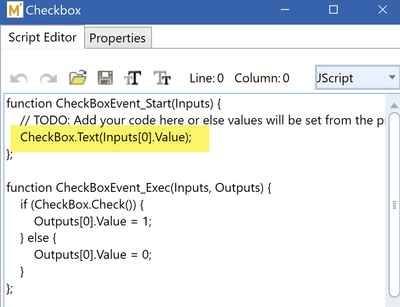

So your actual goal was to provide the label texts for the checkboxes via a matrix of strings?
Here is a way to do it, even though it may be not that straightforward as it would be desired.
The checkbox script is the same for all
They use an input which is the string to be displayed and are assigned vector elements. So the indices have to be changed individually for each check box:
It would be nice if the number of checkboxes could be controlled by the number of entries in the OptionYText vector, but thats not possible with this approach - you have to create the number of check boxes needed in advance.
Prime 11 sheet attached
