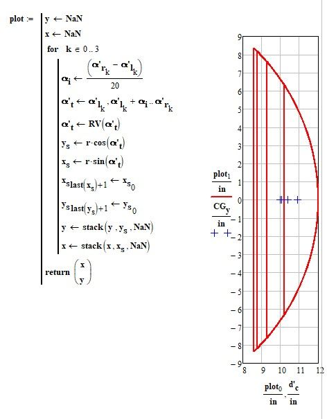

Attempting to use double subscripts to plot for unique circular segments. Can do it one at a time.
john_clark
I am using Mathcad Release 15.0 and DatecodeM050
Need to plot circular segment for four different cases. Need help setting up. see page 19
Sheet one dose it individually, Sheet two wit T on name is my attempt to do this. See page 19.
Here are the errors that I faced
See sheet
Don't know how to upload my sheets.

The problem is somewhat clear.  On page 19 is a plot of a segment/chord of a circle.  The plot is changed from one of four possible diagrams by changing a variable kk above the plot.  The poster wants to automate all four.  Not sure what automate means - all four at once?

I’d like to combine 4 plots onto one.

Hi John,
Here is one way:
Cheers
Terry
john_clark
(To:terryhendicott)
Thank you again.
Works perfectly
