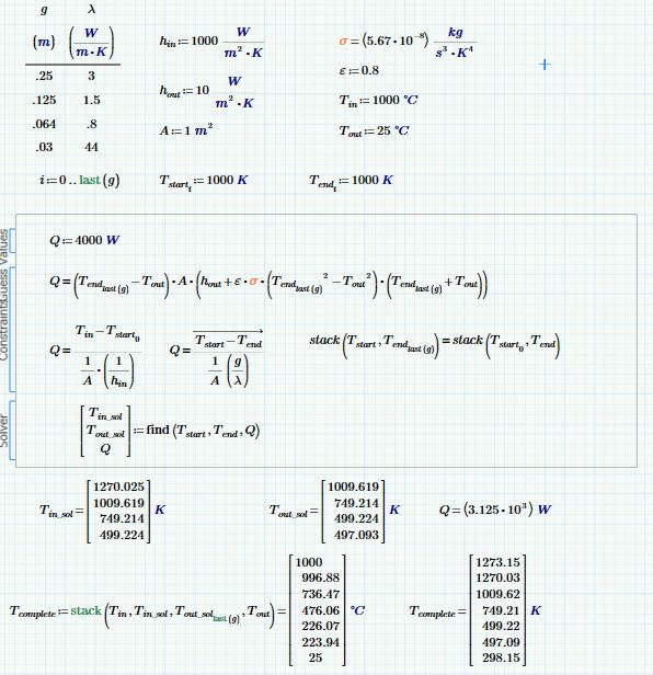

I'm looking a way of automatic solution of HT problem with multilayer steady heat transfer with numbers of layer dependency.
I'd like to put n variable as number of materials layer then put thicknes and thermal conductivity as a consequences of layer namber and finally get a solution for n=2,3...k layers.
Thank you in advance for any idea
I enclose MP 4.0 file.

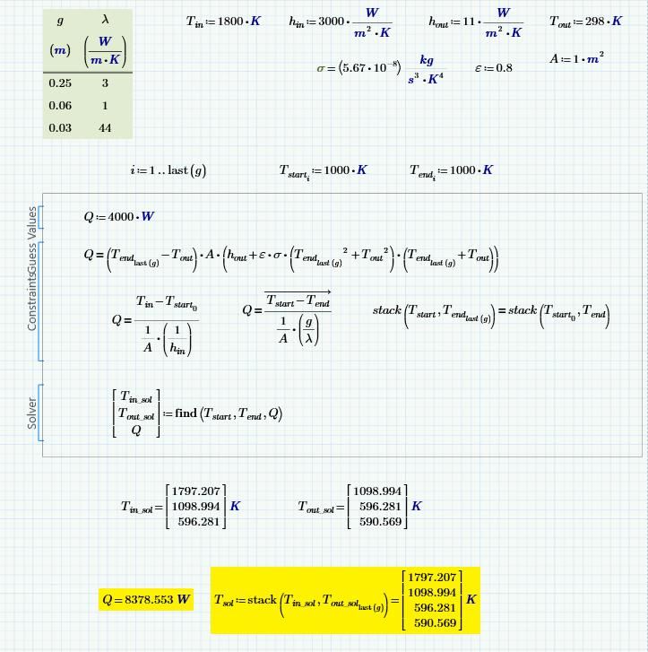

I think the link did that, although yours is complicated by having different equations at the start and end. But the concept is the same. Since I can probably use something similar someday, I took a stab at it. Seems to work - you can add or delete rows to the table. But user beware, etc.
T_start is the temp at the start of a 'plate', and T_end is the temp at the end of a plate.

The problem is that I have to solve the non-linear equation due convecting and radiation therms which are set as outflow boundary condition.
This is a first step to get interlayer and inflow temperatures.
Note that your solution changes the value of Q. Might try taking it out of the Find statement
I thought that finding Q was the (eventual) point. If I define the temperatures then Q is a result, not an input. Otherwise I'd need to change thicknesses or heat transfer. Original post solved for Q, but never called it that - they just set the equations for Q equal to each other. But I didn't study it very hard so maybe I'm not understanding their question.
I understand the confusion.
If you have the inside/outside temperatures given, then solving for Q and the layer by layer makes sense and should work.
If you set Q (and wither the inside OR the outside temperature), then you can solve for the whole temperature set.
I didn't realize you were solving the first problem. Sorry!

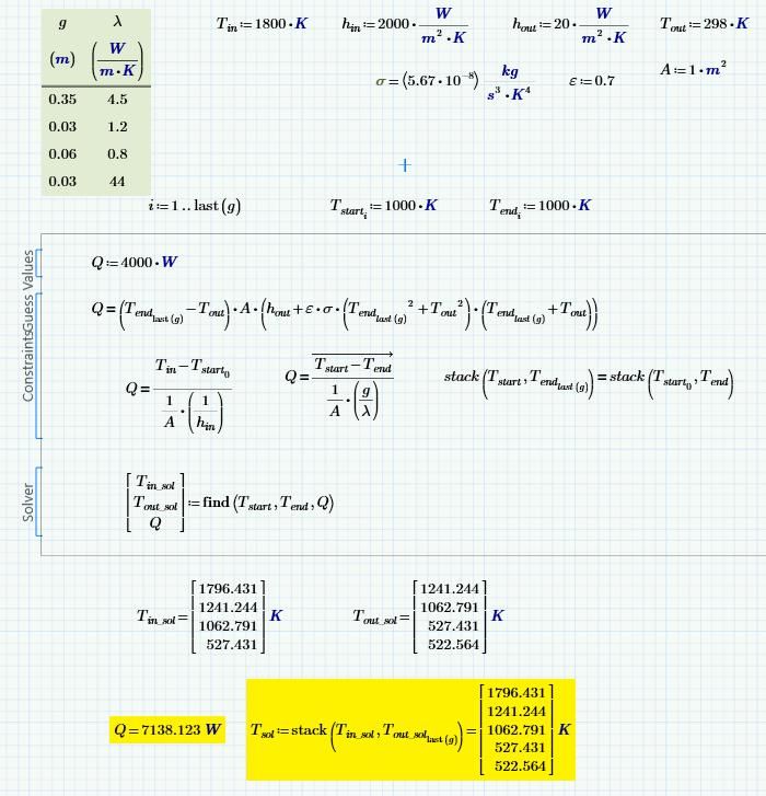

Thank you DJF, your solution work perfectly.
I have overlooked my own mistake in first post. In quadratic part of radiation therms should be plus instead minus.

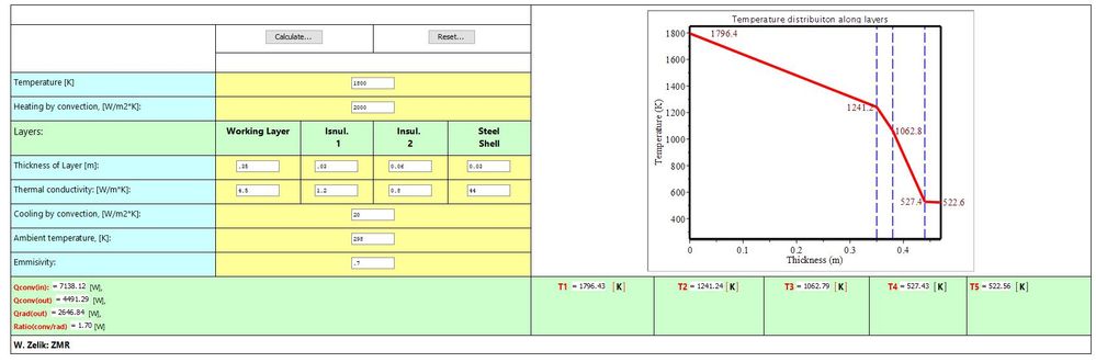

I have checked solution with my old maple mathapps. The results are the same.
Below comparison of 3 and 4 layer solution done in MathCad and Maple.
Q vaule is also correct. it is no surpise beocuse Q=4000W is starting point for looking solution.
