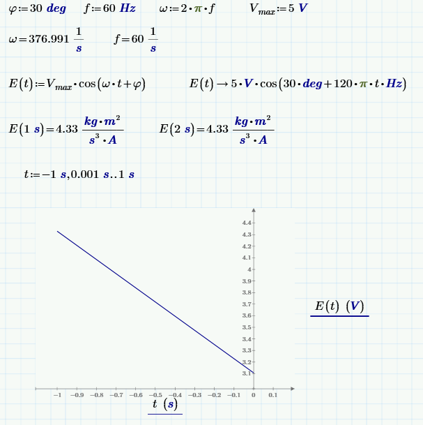

Greetings,
I just started learning Mathcad and have been getting incorrect calculations using the sin function, when t=1s and 2s, Mathcad gives me the same result and the result is not even correct (t=1s, it should've been 3.41 not 4.33; when t=2s, it should've been 2.193), I am also getting a straight curve instead of a sin wave. Can anybody help me out? Capture.PNG

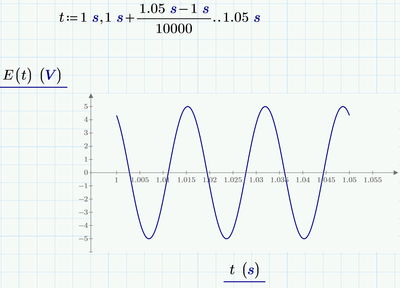

Change your Range Variable, t....
You are plotting only 2 points -1 and 0.001 and it is drawing a line between the two points.  The first point is -1 sec - the second point is 0.001 seconds - that gives an interval of 1.001 seconds - therefore the thirdpoint would be 1.002 seconds which is larger than the final limit of 1sec....
You clearly wanted to plot from -1. to +1sec in 0.001 intervals....
Change the range variable to
     t:=-1 s,-0.999 s .. 1 s
that should fix it....
Hope that helps....(dont have MC installed at home so I cant fix it or show an example).

Do you know why when I used t=1sec and t=2sec, I was getting the same and incorrect result from E(t)? The results should be different.
mpomerleau
(To:Jim35)
Yeah,
Those answers are both correct - because your frequency is an integer.
Your function is periodic - freq - 60 Hz.  It repeats exactly 60 times a second......
In the time interval from One Second to two seconds you would have gone through exactly 60 cycles - and be at exactly the same point.  Any interval which was a multiple of 1/60 seconds would get you exactly the same value.
Change your frequency to a non integer - i.e. (60.1 Hz and you will not have the same value at 1 and 2 seconds).
