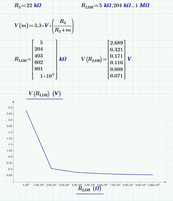

I don't understand what is happening here. I have a range of resistances I put into a variable. Then I just want each solution using the basic voltage divider fuctionfunction.

First and before all: Attach your Prime worksheet, not only/just a picture.
It appears like you forgot to type a multiplication (*) between the V and the ( in the expression for V(m)...
But to be sure, the worksheet is needed.

Unreal. That is 100% correct. I was going mad.
Thanks heaps, greatly appreciated.
