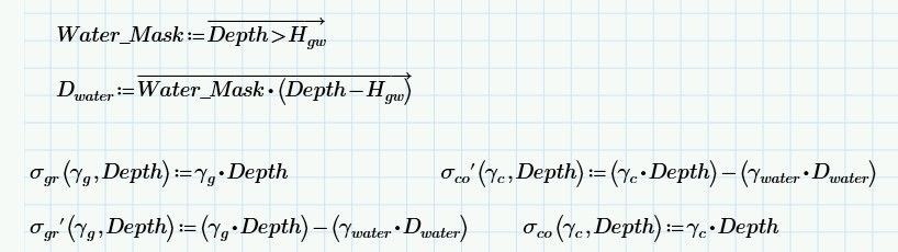

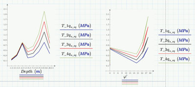

I have been working for maybe a month now on my worksheets for geotechnical calculations and so far, with the support I have been getting from this community, I have been progressing very well so thank you !
Now I wanted to ask if anyone has any suggestions on how I can present my data like this (see image below).
I believe it would look better rather than presenting it this way (see below). So basically I wanted to create a graph that can provide the bearing capacity with respect to varying footing width sizes.
I have attached the mathcad file below. You can go directly to the last page of the sheet. Thank you in advance!
(To:CF_10130026)
And "footing width size" is which variable in your sheet´? Its not clear to me which variable you would like to plot over which??
BTW, you wrote
Are you really sure?? 45 radiant, not 45 degree?? Are you aware that Mathcad like most other math programs assumes an angle to be in radiant unless otherwise stated?

Hi Werner_E,
Thank you for your reply! Basically the y-axis is the T_1q_sq and the x-axis is the Bf at different sizes. So maybe a function for Bf should be defined for the different footing sizes?
As for the N, no I wasn't aware. I'll add the degree sign then, thank you!
(To:CF_10130026)
But T_1q_sq is a vector consisting of  8 values!? What would you like to see as y-value?
Furthermore it looks like changing the value of Bf has not much effect as you can see here:
