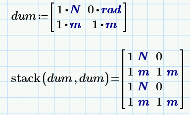

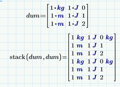

Beware of using the "stack" function with mixed unit matrices containing zero terms without units. Prime seems to "leak" the units from another term to the unitless zero terms:
Given that Prime is fairly pedantic about using units - even on zero terms- subsequent computations using 0.N instead of 0 will fall over.

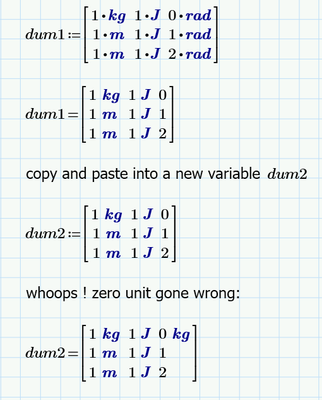

This can unwittingly happen when radians are used, and you expect the value to remain a pure ratio. The get around is to ensure radians are inserted at source - even though Prime strips them off in subsequent results:
If you copy and paste this result, into another expression, the rad unit will get swapped out for another:
However, this is of no help if the zero value is not an angle e.g. a zero count value.

BTW, it has nothing to do with the stack function. Simply evaluate dum after you defined it and you will see the same effect.

EDIT: Concerning the (pseudo)units rad and deg
You don't need to copy & paste. If you use an inline evaluation when defining the matrix you can experience the same undesired effect.
