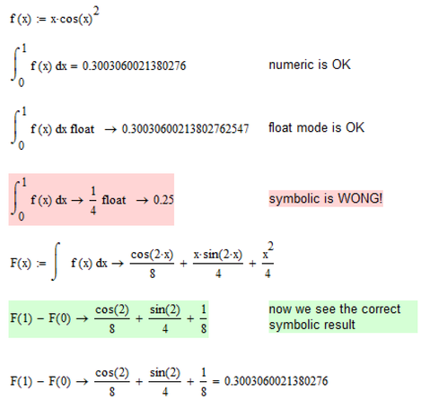

Just in case that anybody still is interested in Mathcad bugs:
This was done in the current release of Mathcad 15. I guess we would see the same bug in Prime.
Its likely that the bug will not show up in Mathcad 11 (with Maple as symbolic engine instead of the current old version of muPad).

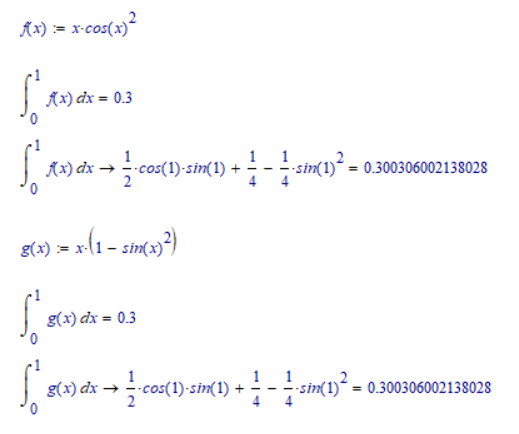

Oddly, the following equivalent works ok!!
Alan

Its a strange bug. In the past most bugs with definite integral originated in the fact that the symbolics first solved the indefinite integral and made some assumptions which did not apply concerning the limits. But this one seems to be different.

Just for confirmation, Mathcad 11/Maple:
(To:LucMeekes)
No big surprise - I guessed MC11/Maple would not faíl 😉
