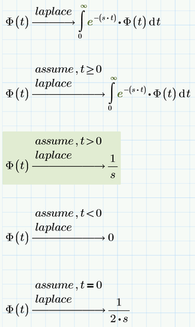

Here is a workaround and some "funny" side effects.

This is NOT a bug. The symbolic answer is completely true.
However it shows an incapability of Prime 6's new symbolic engine.
(To:LucMeekes)
Of course, one can discuss this excellently, whether it is a bug or "only" just inability, if a software claiming to be a math software is not able to evaluate an expression like this. Some may perhaps call it a sham.
However, it is always better if the software just gives up, as in this case, rather than returning an incorrect result, as its the case since Mathcad 14 with various symbolically evaluated integrals.

More correctly you should write like this, even if nothing changes:
