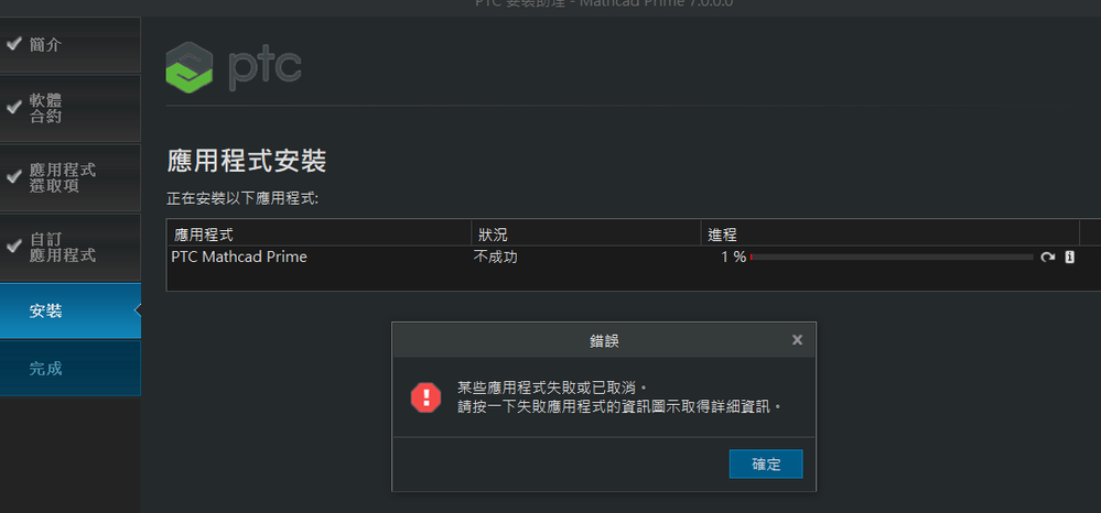

According to the information provided by PTC, I followed the installation steps mentioned in the knowledge base article. However, regardless of whether I checked the option to install the converter along with Prime, the installation process fails at 1%. This is indeed a challenging issue.
In the meantime, I have contacted the PTC support department and reported in detail my installation problem and the converter's inability to function properly. I understand that resolving the issue directly with PTC might be complex, and I am currently awaiting their response. However, due to the urgency of the file, I had to seek assistance from others.

As I already wrote, if you want us to convert some files, you will have to post them here.
But if you experience that the installation of Prime hangs at 1%, as I understand it, you don't have a working Prime installation to open the files.
But maybe I misunderstood and you had already installed Prime and the installation only hangs when you try to add the converter.
Anyway, just attach the file(s) you want to be converted here and someone sure will be willing to convert them into Prime 7 (or earlier) format.
