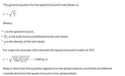

and Chat GPT says
 And  Gemini AI says:
If you need a rough estimate, you might find references to the speed of sound in wet steam being around 10% lower than dry steam at similar conditions. However, this is a simplification and won't be accurate for all cases.

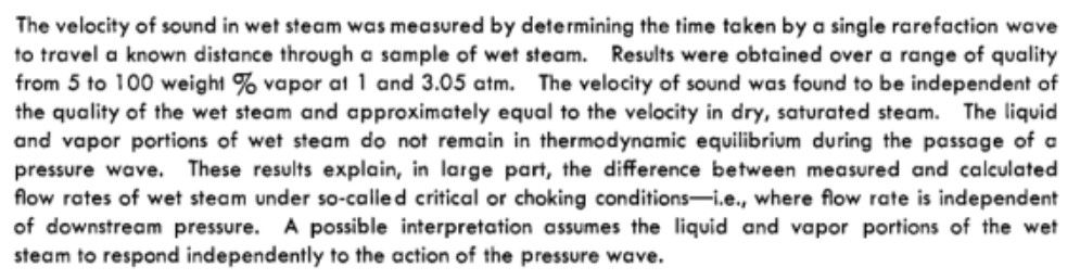

Your reference says no measured data is available?:  But there is one that has measurements of wet steam.
ON THE SPEED OF SOUND IN STEAM
Pavel Šafa?íka,?, Adam Novýb, David Jíchaa,b, Miroslav Hajšmanb
Papers [5, 6] provide much stimulation for further studies of the speed of sound in wet steam, because they deal with the propagation of waves in wet steam. However, no measured data have in fact been published.
[5, 6] are not this article:
Velocity of Sound Measurements in Wet Steam
R. E. Collingham and J. C. Firey

Hi, and thank you for your coments. I had read that paper in detail. It refers to a mathematical development of an earlier paper by the same authors as a pure numerical model, but the conclusions. section 5, notes "It should be pointed out here that no measured data are available for the speed of sound in wet steam, and there are also only limited theoretical resources". I am hoping someone knows of a newer resource which is compared to experimental data. Figure 4 in this paper shows a discontinuity in the velocity curves at a steam quality about 0.98; but it is not clear is any experimental data supports this obsrvation.
I have read the 1963 paper by Collingham and Firey, and the later 1966 paper by England, Firey and Trapp. on measurement of the speed of sound in wet steam. However, the method shows significant experimental issues that may be affecting their results. But, that said, I have not (yet) found newer experimental data.Maybe when I have read the paper by Kieffer it will be clearer, but that appears from the abstract to be another theoretical study.
