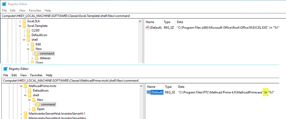

Inspect your (Windows) register to see how the unctionality you want is implemented for MsOffice applications, and implement the same/similar for a mathcad template sheet and see if it works.
Thanks for the response. I tried exactly that. Unfortunately, the MathcadPrime.exe doesn't support the switch /n as Excel.exe does. Unfortunate.

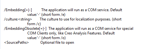

Looks like Prime does not offer this feature and only supports the switches /c. /e and /o
