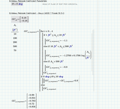

I have a for loop  that generates a 5x1 vector for one variable
To which i use GCpnegzone4 5x1 to generate wind pressures in the following loop

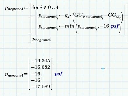

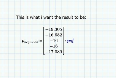

Which works... however i need to clamp the values to a minimum of -16psf per code. meaning it should look like this:

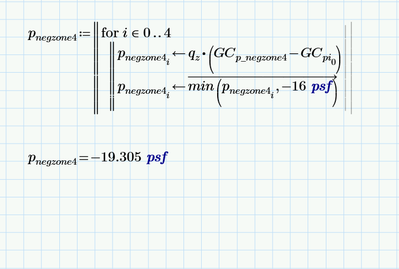

the approach i have been using is taking the same for loop used for Pnegzone4 and adding a the min function in hopes that it will go by element and compare the min value and replace when necessary. However the code just reports the lowest value as show below:
Any help on how it should look like would be appreciated! my file is attached

*face palm* on my end.
Thank you !

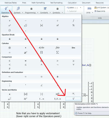

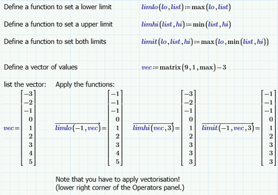

Of course there are other ways.
For vectorisation, see below.
Succes!
Thank you for the second option as well! This will help me grow as a user of mathcad so I really appreciate the help
