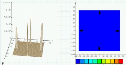

Its unclear to me what kind of matrices you'd like to create but maybe the attached Prime5 file can help with plotting the data

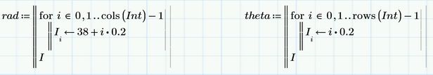

Dear Werner, Can you integrate your approach into a new file I've submitted? I used DJF routine to create data-file that can be exported to other software. However, I really like your approach since it enables fast visualization of data within Prime5. I tried to do this myself, but your undocumented trick (not anymore :)) stopped working for some reason Thanks, zjv
(To:zjv)
Not sure which problem you ran into - I don't see any error or that you copied any necessary regions into your sheet .
You don't need to use the undocumented trick I mentioned to create the necessary vectors. You already did it using normal program routines.
So simply replace my "vec_r" for your "rad" and you may create "vec_t"  using your  "theta" by simply writing "vec_t:= theta*deg" as the values you provide obviously are in degree and not radians.

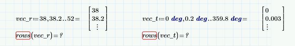

Hi Werner, I don't know why but I still had problems with integrating your part with my document. For some reason, the part shown in image below was not possible to calculate (rows(vec_r) and rows(vec_t) was reporting an error ???). However, when used in your document alone, everything worked correctly. Thus, I decided to split file - one for exporting data (merging parts from DJF) and other for plotting (your approach). Thanks!

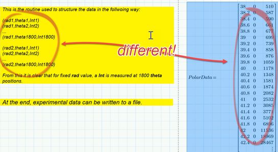

BTW, your description does not correspond to the data structure you create:
zjv
(To:Werner_E)

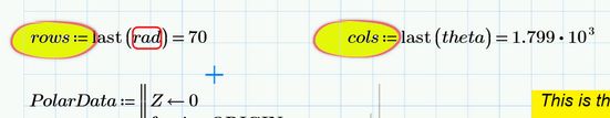

Werner, thanks for the comment, I haven't noticed an error before. Now it is corrected. The file is attached. I still have a problem with vec_r and vec_t error like as shown in attached image.
(To:zjv)
The problem is that you defined variables "rows" and "cols" and therefore the built in identically named functions are not available anymore.
Solution: Use different names for your variables. As variable names are case sensitive you may even call them "Rows" and "Cols" if you like.
