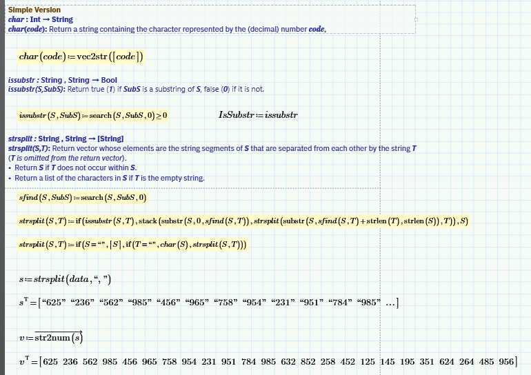

For those of you watching in Prime Express 7, here's one way of converting a separated string of numbers to a vector of numbers:
Stuart
(sfind isn't really necessary; it's only there to shorten the first line of strsplit)
For those of you who noticed strsplit's reaction to an empty string for the separator string T, I'm afraid you'll need to either vectorize char(S) or use the more complicated version of char.
I've added strjoin (and a few supporting functions, including a replacement for Prime's faulty search) to the attached worksheet - they're in the collapsed Area.
