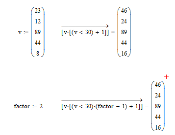

I would like to multiply only certain numbers in a matrix. Only numbers lower than a certain variable.
Lets say I have a 1x5 matrix [23 12 89 44 8] and I want to multiply all numbers less than 30 (in the matrix) by 2.
New matrix would output the following:
[46 24 89 44 16]
Can someone point me in the right direction...
Thanks!
4 REPLIES 4
AlanStevens
(To:IRarch)
As follows:
Alan

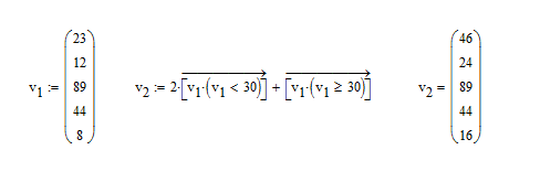

-MFra-
(To:IRarch)
es kann auch klassisch gemacht werden ....
IRarch
8-Gravel
(To:-MFra-)
Thank you so much, this worked perfectly...

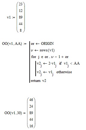

(To:IRarch)
OK, so here's a third variant

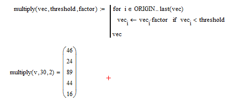

and here a further "classic" one turned into a function
