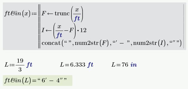

if the result is in feet, Is there a direct and simple way or a function to convert it to feet and inches?
For example L=6.33 feet          L=6'-4"

Unfortunately Prime does not offer this way to display a length.
You would have to write and use a custom function to display it similar to the desired look.
Here is a simple (and limited) function which returns a string to display the desired result
For a different and more comprehensive approach on this you may have a look at the work of Fred Lusk
Lusk_Feet Inches & Fractions Calculations

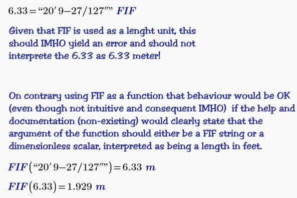

Forgot to mention that Prime offers a unit (!!?) FIF
Its a bit buggy that FIF used as a unit can also be applied to a dimensionless number (which then is interpreted as a length in meter!!)
