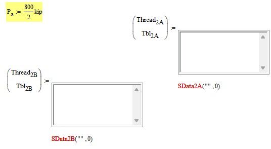

I’m currently working on a Mathcad worksheet that wasn’t originally designed by me. I need to convert this file to Mathcad Prime, but I’ve encountered some issues after the conversion. These problems are affecting the functionality  of the worksheet, and I’m not entirely sure how to resolve them. Has anyone else faced similar challenges? If you have any tips, advice, or solutions, I’d greatly appreciate your help.

The Mathcad 15 sheet is not working OK because the variable names in the script(s) do not match the variable names used in Mathcad.
I changed a few occurrences of "T2A" to "Table2A", etc. and this made the MC15 sheet work OK.
The converted sheet still fails in Prime - no surprise (after all its just Prime and not Mathcad). Especially scripted components need a lot of rework after conversion.
I attach the fixed MX15 sheet together with Prime's poor conversion attempt
Any suggestions how can this be fixed in Mathcad Prime?

Not really. Haven't looked in detail into the scripts and why they fail in Prime.
You will have to look at the scripts in detail, find out what the originator of the sheet had in mind what they should achieve and then try to redo them with Primes limited abilities.
Main problem seems to be that Prime won't allow a scripted component to be assigned to a Prime function. In Mathcad this was possible by providing the function arguments also as component inputs, but in Prime doing so throws an error.
I don't know if its possible at all to use a scripted component as a function in Prime. I am not sure but I fear that turning a scripted component into a Prime function may not be possible at because Prime being too limited.

It seems to me that the scripts are just a very complicated way to hold and handle thread data. If so, you only need two Combo boxes:
I've opened the latter for editing, so you see how they are set up. Note also the transpose after the first - it allows the variable list as single row instead of vector.
