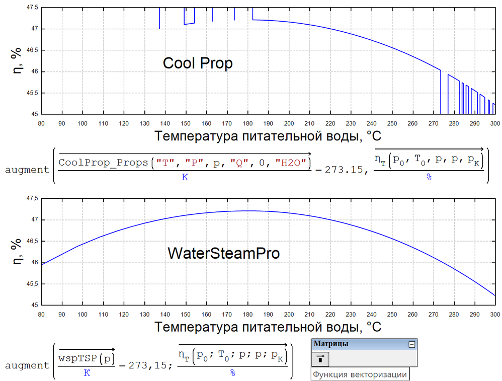

Cool Prop IF97 vs WaterSteamPro
@ValeryOchkov What is the JeffH1_0-1701310920046.png function that you are plotting against the Liquid Saturation Temperature?
What are the parameters being passed in?
@ValeryOchkov - Thanks for this.  I've looked at your SMath document and reproduced it in Mathcad, with errors.  Indeed there is an error when using IF97, but not using the default HEOS for water (which uses IAPWS-95) and not in the IF97 backend.  The trick is that your efficiency function makes a few calls to the backward formulation for h(p,s).  There is no function documented in the IF97 release for this so CoolProp has evaluate it manually in all phase regions, which is fairly straight forward.  In the two-phase region, however, it requires a lever law calculation, which is not being evaluated correctly (although I'm not sure why yet).   I will look into this and make sure something gets into the next patch release.

After some time, I was able to reproduce your SMath document in Mathcad Prime and verify the issue with CoolProp.  It was easy to verify, not so easy to figure out why it was occurring.
The issue stems from the fact that:
  1. IF97 does not provide functions of h(p,s).  These have to be evaluated by calculating temperature from T(p,s) and then using h(T,p) to get enthalpy.  These functions involve some uncertainties (±25 mK) that can provide (T,p) state points that are just slightly on the wrong side of the saturation curve, returning enthalpies in the vapor phase rather than the liquid phase.
  2. This problem was exacerbated by calculating saturation temperature (Tk, T'H2, T'H1, etc.) from pressure using Tsat(p), which has some uncertainty (±0.007%). The efficiency function then uses that temperature to get saturation enthalpy/entropy from h'(T) and s'(T), which do not exist in IF97, so the code has to convert Temperature back to saturation pressure (adding another ±0.007% uncertainty) and then calling h'(p) and s'(p).  These errors can be removed by calling the saturation functions of pressure h'(p) and s'(p) directly without evaluating the saturation temperature at all.  This removes the uncertainties added and (mostly) returns enthalpies and entropies on the correct side of the saturation dome.

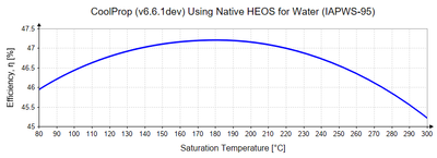

However, the saturation temperature from the reverse functions T(p,s) and T(p,h) should still be returning values that are limited to the correct phase, depending on the input state point.  This has been corrected in CoolProp (Github.com/CoolProp/CoolProp PR#2404) and it's underlying IF97 backend (Github.com/CoolProp/IF97 PR#49) to behave more robustly very near the saturation curve, which is where the efficiency equation operates.  Here are the efficiency plots (reproduced in Mathcad Prime) using both the native HEOS (IAPWS-95) and IF97 backends for Water.
These robustness improvements to the reverse functions will be included in the next release of CoolProp (6.6.1).  However, the improvements are included in the nightly build on SourceForge (v6.6.1dev) of the current development version.

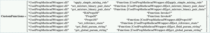

I'm a longtime user of Mathcad 15 with steam table extension and a novice using Prime.  I've copied the latest CoolProp .dll file to the "Custom Functions" folder but Prime doesn't recognize any of the thermodynamic functions.  I'm looking for some help using CoolProp in Mathcad Prime.
The best stwem tables for Prime 6 is WaterSteamPro
Make sure you've got the correct DLL.  The one for Mathcad 15 is 32-bit, while the one for Mathcad Prime is 64-bit and compiled specifically for Mathcad Prime.
1. With the DLL in place, restart Mathcad Prime and enter, CustomFunctions= .  If the DLL is the correct one, and properly installed, you will see the following list of functions available from the DLL:
If you do not see this list of functions, you do not have the correct DLL.
2. Also on SourceForge, where you got the DLL, is an example Mathcad Prime file called CoolPropFluidProperties.mcdx.  Once the DLL is installed properly, download and open this file in Mathcad Prime and press <Ctrl>-F5 to update all equations.  This document will show you how to use the functions.

With your insights I continued searching until I found that the Mathcad Prime DLL for CoolProp revision 6.3.0 seems to work work well for me.  I can list the functions with CustomFunctions= and all of the functions I've tried so far return expected results.
