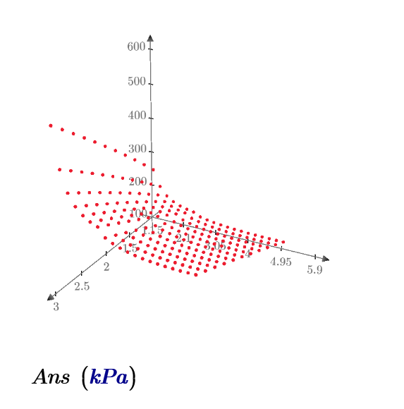

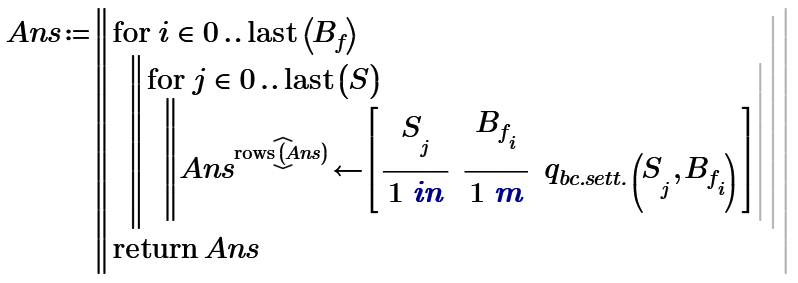

Thank you @ttokoro . What is purpose of using third brackets " [  ]". Is this for assigning the matrix values in each corresponding cells inside the "Ans"
ttokoro
(To:fahmed-2)
Your sheet shows error mesage for x and y data must have no unit. So I make Ans as [x y z-value with unit].
And stack all S and Df  and  its Ans.
I try to use [NaN NaN NaN] to stack. In this plot, z axis also has no unit.
fahmed-2
(To:ttokoro)
@ttokoro thank you. why was "not a number (NaN)" required for stacking...should not it be stacked by itself without using NaN. Please help
ttokoro
(To:fahmed-2)
Instead of point data, [NaN NaN NaN] turn off to connect each 3D point [x y z] data by stacking.

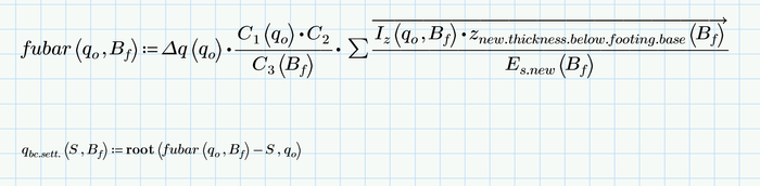

In fact, the error message reveals the cause and also gives the hint to the solution of the problem:
The variables for the independent variables (x, y) must (unfortunately) be unitless. Only the dependent variable (z), i.e. the function result, may have a unit.
So omit the unit meter at the range variables and add them when calling the function.
The plot takes "endless" to finish because the function seems to be defined quite inefficient.
You sure should consider to implement the improvement I suggested in another thread of yours which at least speeds up the calculation for the factor 5.

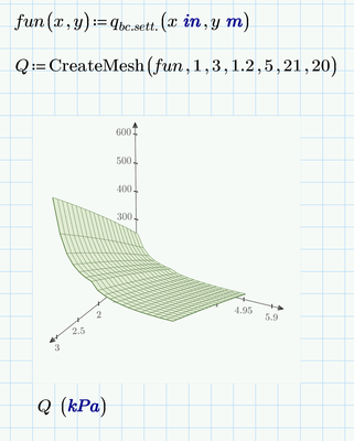

Personally I would prefer using CreateMesh() instead of range variables

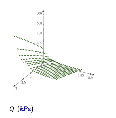

Thank you @Werner_E . Is it possible to make the plot as individual dots
(To:fahmed-2)
Sure! Simply format the plot that way
I used the data  structure created with CreateMeashj() but you can do the same with the plot using the range variables.

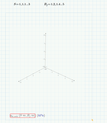

Also, I am having the following image using your process @Werner_E . The box was marked "red". Please help
(To:fahmed-2)
And the error message is?
As far as I see your comp is still computing......

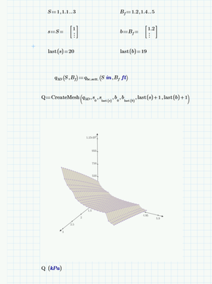

Personally I would prefer using the CreateMesh() function anyway
File (Prime9) with a speedier function attached

It takes very long to calculate, even if you apply the speed up modification I explained in the other thread of yours.
Here is the speed-up again as used in the current sheet of yours:
Mind the vectorization!

how do I get "CreateMesh" function
(To:fahmed-2)
Its a standard function in Prime. Its sure available in your Prime7 as well.
I guess it was even implemented in the very first Prime version 😉 The 3D plot has not improved since then.

Actually I don't understand why you refuse to speed up your function calculation as already shown.

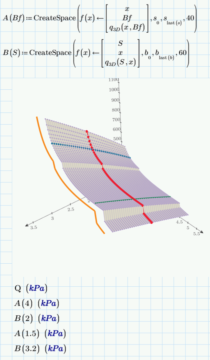

Can alternatively be achieved using CreateSpace()
May be formatted with lines and/or points. Unfortunately Prime provides only one size which is equally valid for points and lines. Workaround would be to use two plot traces 😞

Thank you @Werner_E . This is awesome!! Please advise as why did you put numbers 40 and 60 for defining A and B, respectively.
(To:fahmed-2)
Just to get a finer resolution. Default value would be 20 if you omit this parameter (see the help info for CrreateSpace()  and also for CreateMesh() ).
As you can see in the picture I also used a finer grid for the surface, too, to et a bit more details. It takes longer to calculate, but as I implemented the already mentioned speedier function we can wait for it to finish.
