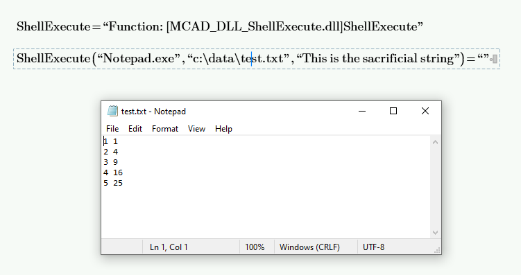

Good afternoon,
As titled, I am crafting a general purpose ShellExecute that will run inside Prime.  I have it working.  But there is an issue with a null pointer.
My approach was to pass strings.  These are strings that define the EXE, and the command line.
An example would be like this:
ShellExecute ("Notepad.exe", "c:\\data\\test.txt", "Null")
The problem is that I had an issue with a null pointer being passed, so I had to create three MCAD strings like this:
LRESULT ShellExecute_MCAD(MCSTRING* pMCS_Empty, MCSTRING* pMCS_Process_EXE, MCSTRING* pMCS_Process_CMD)
here is the Visual Studio cpp file.  I can also attach it if needed.

When I run this, the only way this works is to place a sacrificial string at the end of the call.  Here is a screenshot:
Can anyone provide guidance as to why this is happening.
Thank you.
July 16, 2022
"Can anyone provide guidance as to why this is happening."
Potentially...
I've understood that the LRESULT 'function' takes as first argument a specification of the function result.
In your case that would be a string. The next arguments to LRESULT define the parameters to the function, you'd like two parameters, both strings.
Then it should look like:
LRESULT ShellExecute_MCAD(LPMCSTRING pMCS_empty, LPCMCSTRING pMCS_Process_EXE, LPCMCSTRING pMCS_Process_CMD)
Note the difference between LPMCSTRING (for the return value) and LPCMCSTRING for the arguments.
The the FUNCTIONINFO 'function' would not specify 3, but 2 arguments with { STRING, STRING } instead of {STRING, STRING, STRING } on the following line.
I see that your function uses a variable L_Result, that is not used elsewhere. I should think that your function might return an indication of the success or failure of the shell command execution, in the form of an integer value; in that case you'd want to return a scalar instead of a string to Mathcad.
Hope this helps.
7-Bedrock
July 19, 2022
Good morning Luc,

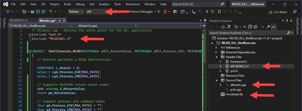

Thank you for your reply. Using this, I found more documentation based on your explanation and was able to move this further and include error codes.  It appears to be working nicely.  I will note that I cannot seem to trigger any error codes other that file not found. Anyway, I do appreciate your help.
// dllmain.cpp : Defines the entry point for the DLL application.
#include "pch.h"
#include "MCADINCL.H"
LRESULT ShellExecute_MCAD(MCSTRING* pMCS_ReturnValue, MCSTRING* pMCS_Process_EXE, MCSTRING* pMCS_Process_CMD)
