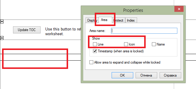

 Thank you very much for the idea on dynamic tables. When we are converting the math cad document into PDF copy how can we hide the push buttons?
To hide the necessary objects in your worksheet you can use the "Area" option. In the "Area" properties exclude: "Line" and "Icon".
Dear Vladimir ,
 Thank you very much for your suggestion.
