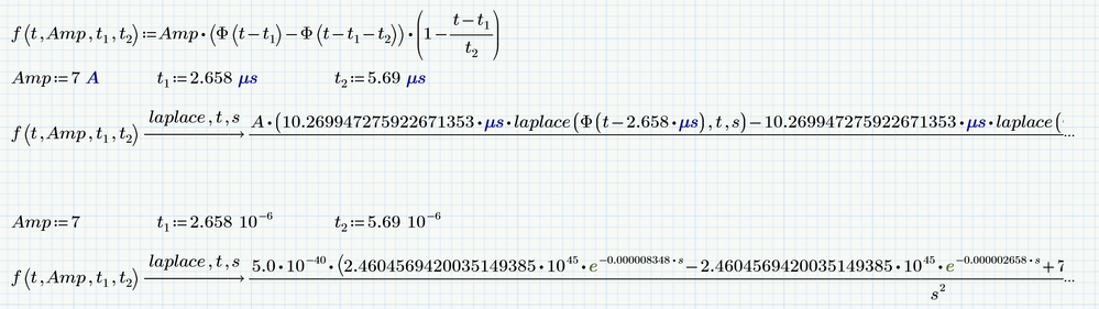

(To:xyz123)
Shouldn't you replace t.3 in your definition of f(t) by T. After all t.3 seems to be a duration, not a time stamp.
As Luc already wrote, the symbolic "laplace" does not work with conditionals (if's).
I am also not sure about trunc and/or mod (which you would use to make a periodic signal) and the used units. After all the symbolics does not know anything about units and treats them as unknown variables.
Using Fourier would require you to trunc the row and would just be an approximation.
EDIT: I just gave it a try and redefined f(t) using the Heaviside function as suggested by Luc.
We can laplace transform f(t), but as soon as we use "floor" to make it periodic, the symbolic is not able to transform it in a usable way - you see the calls to a (non-existent in Prime) laplace-function in the result.
I haven't tried, but I guess that different ways to make the signal periodic (using the "mod"-function e.g.) will have no success, too and you will have to resort to other methods to solve your task. Maybe the pdfs of @-MFra- , posted by @Derbigdog  will be of help.

24-Ruby V
(To:xyz123)
As you can see in the next picture it looks like the symbolic laplace operator fails because of the units. So you may give your sheet a try by stripping the units. Take care of the labeling! Both "t", the function argument and the argument of the laplace operator must have the exact same label (either both (-) or both "variable").
I have not tried but I could imagine that MC15 sufffers from the same problem as it uses the same symbolic engine as Prime 3 (and the versions up to P6).
But it looks like it got worse.
The new symbolic engine introduced in P6 (and its the only one available in P7) is even more critical as it needs to be told that t is greater than zero to be able to laplace transform the simple Heaviside step.
Thats also the reason why I did not succeed in laplace transforming a simple rectangle (at the right hand side you see the results given by the legacy symbolic Mupad).
So far I could not be bothered downloading and test driving Prime 7, so I don't know if the problem still is present there. After all they promised an improved symbolic, didn't they.
In case you don't know - Luc uses MC11 and this version used Maple as its symbolic engine which of course is (even though its a rather old and stripped down version) still far superior to the engines now used. So what he shows often does not work in newer versions.
Both Mathsoft (former owners of Mathcad) and Mathworks(ownern of MatLab) changed their symbolic engine from Maple to Mupad around 2006 (Maplesoft probably did not extend the license). Mathcad was bought by PTC soon after. The difference was, that MatLab bought muPad and so Mathsoft/PTC had to license the symbolic module from them. Thats also the reason PTC was eager to get rid of muPad and implement its own thing based on a free engine.
