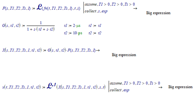

Hello Guys!
I want to analyse my circuit, using laplace transformation.
Step 1) First I have to generate a triangle waveform.
I have all informations given like peak-value, duty cycles, frequency, and so on.
I could obtain a triangle waveform by defining sections with the if-equation, according to the post from Werner:
https://community.ptc.com/t5/PTC-Mathcad/Plots-for-Conditional-Function/td-p/124048
My first idea was to multiply a sawtooth function with a rect function, but nevermind. I keep the solution from Werner I guess if the following Step 2) will work...
Another approach would be a fourier row to obtain the triangle shape. Maybe you have some older work / examples here for me?
Step 2-4) I want to make a Laplace Transformation from the triangle waveform, means: i(t) -> I(s)
--> is it posible with my function from Step 1) to do a laplace transformation, or do I have to go the approach with fourier rows?
(Step 3) Vout(s)=I(s)*G(s), with G(s) = Transfer-function of a circuit
(Step 4) Inverse Laplace Transformation Vout(s) -> vout(t) and plot
I am working with Prime 3.0
Best Regards
LucMeekes
(To:xyz123)
Here's an example, first your triangle:
Don't try to use the repetitive signal, due to the mod() function, the Laplace transform will not carry through:
Now we need G(s), to calculate X(s). As an example we take a simple Low-pass filter:
From here, apply the inverse Laplace transform to obtain x(t):
(Yes, it's a big expression)
And plot f(t) and x(t):

Very first check: see if the Laplace transform likes an 'if'-statement. I know it deals with the Heaviside step function OK, but have my doubts about if...
LucMeekes
(To:LucMeekes)
And even if you succeed in finding the Laplace transform of a triangular waveform, which, according to Spiegel "Laplace transforms":
for a triangle with amplitude A and period T and no offset, will be something like:
Then on trying to apply the inverse Laplace, you (may) get:
which means that the inverse Laplace isn't known.

LucMeekes
(To:xyz123)
(To:LucMeekes)
We might not be able to Laplace-transform the periodic made signal, but at least we can repeat it a couple of times using a simple summation which the laplace command accepts.
But I guess that less simple filters might be a problem for invlaplace

LucMeekes
(To:xyz123)
If I made no mistake then:
The Laplace transform of the triangular signal y starts with:
Your filter is:
And with the actual component values the Laplace transform of the response is:
Transformed back to time domain we get x3(t) that starts with:
And the time-plot is:

LucMeekes
(To:xyz123)
You should still be able to use the symbolic result, even if it's 'too large to display'.
Assign your symbolic result to a function such as:
Vout(t, Vin, R, C) := H(s, R, C) * Ltriangle(s, Vin) invlaplace -> <symbolic expression too large to display>
Then you can (or at least, should be able to), plot Vout(t, Vin, R, C) versus time t.
