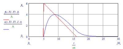

Here's an example, first your triangle:
Don't try to use the repetitive signal, due to the mod() function, the Laplace transform will not carry through:
Now we need G(s), to calculate X(s). As an example we take a simple Low-pass filter:
From here, apply the inverse Laplace transform to obtain x(t):
(Yes, it's a big expression)
And plot f(t) and x(t):

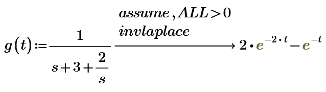

-MFra-
(To:LucMeekes)
Sometimes the transformation or inversion is successful, adding the type of constants used, for example: assume, A = real, assume T> 0 etc ...

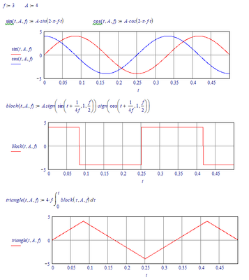

I found another method to define a (symmetrical) triangular waveform:
Unfortunately the Laplace transform isn't found by Mathcad:

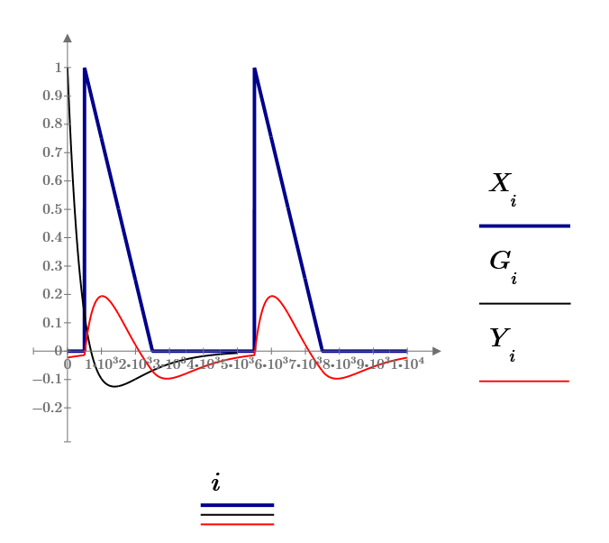

The next step is convolution of waveforms. i means 0.001s sampling,

Number of input signal can change by as same as Werner_E posted.
If we have a impulse response, g(t), Mathcad can show the output signal waveform by using convolution even we can't write the equation of input function. (Just use the A/D signal data for input x(t).)
If we can write the both equations, convolution integral can show the output signal waveform.
ttokoro_0-1613602608404.png  can show the infinity input series response. It is well known as Z(jw) results.

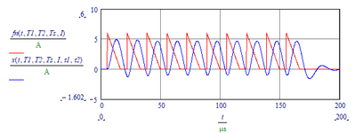

(To:LucMeekes)
We might not be able to Laplace-transform the periodic made signal, but at least we can repeat it a couple of times using a simple summation which the laplace command accepts.
But I guess that less simple filters might be a problem for invlaplace
LucMeekes
(To:Werner_E)
Great idea Werner,
LucMeekes_0-1613577615742.pngLucMeekes_1-1613577666291.pngLucMeekes_2-1613577696290.png
