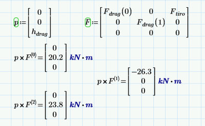

is there a form of executing a cross product of one vector and the various vectors of a matrix.?
Something like this, in matrix form:

The most simple way IMHO would be to write a small custom programmed function with two arguments (a 3x1 vector and a 3xn matrix) which cycles through the columns of the matrix and does the job.
Something like
