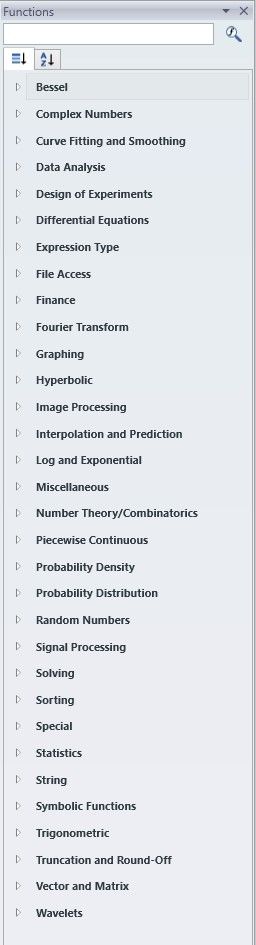

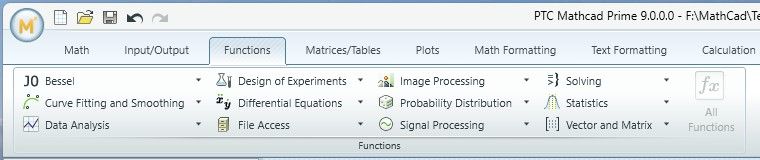

Q2> Where do you find the custom functions as neither the Prime menu or the search for all functions has a section for custom functions?  Mathcad 15 search had a specific spot.

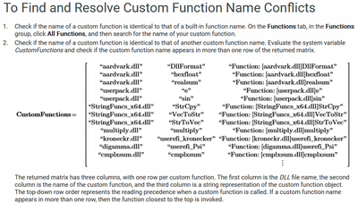

Q2: Ever tried the Prime System variable CustomFunctions?
