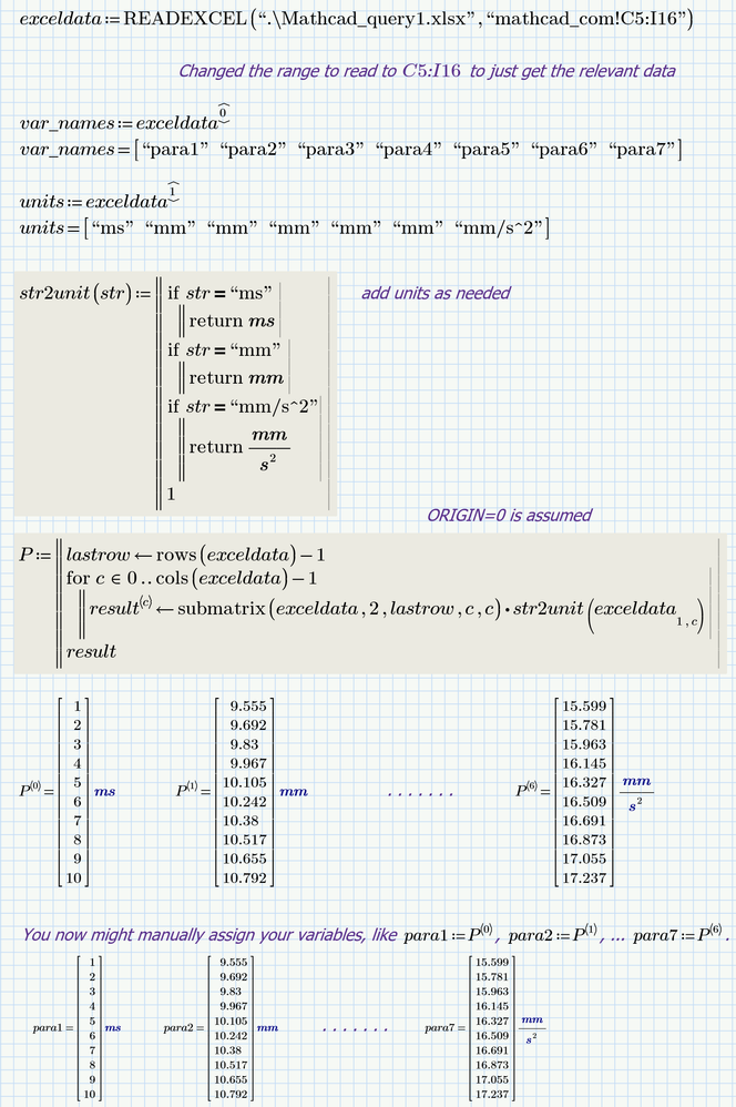

Not sure if the attached sheet will be of much help. The method used might be a little bit faster than yours. Its still necessary to manually type all variable names as i see no way to automatically create variable names bases on the strings read from Excel. Of course it may be possible to write an external program in a language of your choice which unpacks the zipped mcdx file, edits the xml file included to create the variables based an the names in Excel and then resaves and zips it again ... Guess that's not what you asked for 😉
According the "str2unit" function you may be interested in Stuart's work in this thread -> Solved: Re: Not getting the results...

Almost same as your sheet. EXCEL's large value by **E** text can use.
I'm really glad that it's possible to add units via code—thank you!

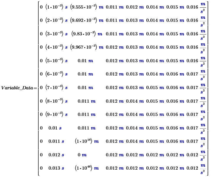

First in Excel format paint from clear cell to selection encompassing all the values (not headers and units).  This is necessary as the copy/paste I am considering will input the numbers as text.  A formatting is in Excel not Mathcad.
Now simply select all the numbers without headers and units.  Now copy this data to the clipboard you can right click after selecting and copy is in the menu that appears.
Go to Mathcad and in a clear area simply paste.  I use [ctrl][V] keys together for the paste.
The result will be an input table where each column is a separate variable.
Variable names and units at the top of each column need to be filled out by hand.  This is faster than the method in your sheets.

Additionally, to simplify things in use, create a blank worksheet in the Excel workbook that references only the numbers from the main worksheet.  Then select everything and copypaste into Mathcad.
Stuart
You can select a large area of contiguous data in Excel by simply selecting top left cell of data, Then [Shift][Ctrl][Arrow Left] together then [Shift][Ctrl][Arrow Down] together will select it all.  No need to create extra worksheets?
Prime 10 file attached

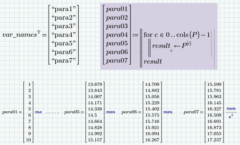

Therefore, for the time being, it will probably be unavoidable to type in all variable names manually - unless you want to work with the identifier P<#> for the data columns instead of para# (but I assume that you have more meaningful names in mind than ‘para 1’ etc).
But you can perhaps make the work a little easier for yourself. I already have the names as strings in the variable “var_name”. You can now display this as a column vector, which makes it easier to type in a new column vector with the desired identical variable names.
You may even just copy this column vector of  strings and manually delete all the double quotation marks to create the vector of names. This can be especially helpful when dealing with longer and more complicated variable names, as it helps to avoid typing errors.
After creating that vector of names its easy to assign the correct data columns to all variables in one go:
Prime 10 sheet attached
