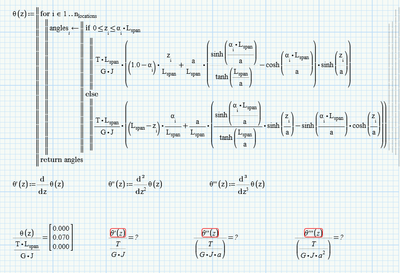

I'd like to check a simple-span beam for the effects of a torsion load along the beam span. This requires some element-wise operations as well as a function for angle of rotation. Attached is the portion of the sheet where I'm running into a vector/scalar error. I'm running Prime version 7.0.
I'd like for the output to include the first, second and third derivatives of the angle of rotation at 3 points along the beam span (the load point in addition to both ends of the beam). Is there a good way to manipulate the matrix setup or include the derivative functions within the main function in order to produce an output?

You can't define the derivative with respect to a vector (z).
I redefined your function theta so that it works with scalar arguments and then call them vectorized with the vector z as argument. Because the values of alpha vary wrt the values of z, I had to define theta and its derivatives as a function in z AND alpha.
Hope it helps. Can't save as Prime 7, so here is a full screenshot:
