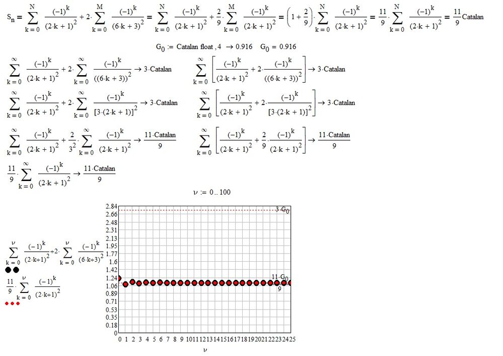

Hello everyone!
Why does the symbolic processor give me different results in calculating the sum of the infinite series shown in the photo? Does Prime produce the same results?

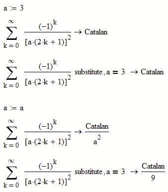

Found something interesting:
So this may be a quite clumsy workaround
But it only works if the variable a is not defined. Otherwise the error pops up again:
But the best "workaround" if one already is aware of this bug, sure is to put the factor outside the parenthesis
Its a strange bug, indeed!

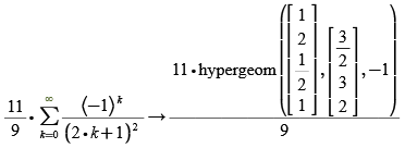

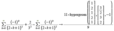

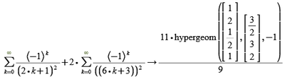

Prime 8 has the 'new symbolic machine' and produces:
and
which is also consistent. Prime 7 is the same.

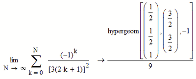

The symbolic is ignoring the factor if its placed within the squared parenthesis.
You get the result which matches the result Luc had shown with P8 if you use the limit

(To:Werner_E)
