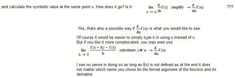

The real-valued function f(x) and its differential quotient df(x)/dx are given. In MC14, this differential quotient for the symbolic value u has to be calculated symbolically. What is the syntax for this? I ask for help.
Kind regards, Alfred Flaßhaar
13 REPLIES 13
Not sure what you actually are looking for.
Is this coming somewhere close?
MC 14 is exclusively about symbolic calculations. We know that the real-valued function f(x) is continuously differentiable on the real interval a<= x <=b. This first derivative, as the differential quotient df(x)/dx, is also a function on this interval. At point u from the interval, f(x) has the symbolic value f(u). How do you use MC14 to calculate the symbolic value of df(x)/dx at position u?
Still not clear to me what you would like to see.
Better prepare a worksheet and don't forget to show what you would like Mathcad to return at the end
Here is the "test". I would like to use the symbolic calculation in higher order of differential quotients too. How is the symbolically calculated value of the differential quotient at point u taken into account as a constant in further/subsequent symbolic calculation?
I think you still don't show what you really would like Mathcad to return. But anyway ... lets assume you did in the sheet and all you were looking for is seeing the differential quotient with x substituted by u ...

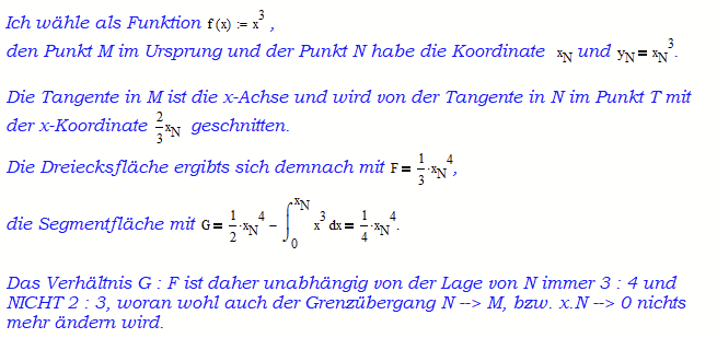

The background to my question is a sentence named after Völler:
In the Euclidean plane, a function f(x) is given as a graph of a four-fold continuously differentiable function and on it the points M and N as well as the tangents in these points with their intersection point T. Let F denote the area of the triangle MNT and G denote the segment area under the curve m above the chord of length MN. The ratio G/F = 2/3 must be calculated for the limit case MN ---> 0.
(Source: Archive of Mathematics and Physics, editor Johann August Grunert, 31st part of 1858, pp. 449-453, "About a strange general theorem about curves", author: Andreas Völler)
What is interesting about this theorem is that G/F=2/3 is independent of the specification of a concrete function f(x). The continuous differentiability is sufficient for this result. The original proof is in principle not difficult. The Bernoulli/L`Hospital rule is repeatedly applied. However, considerable paperwork is required. And I'm trying to simplify that with the help of MC14. Since the proof result is independent of the specific specification of a function f(x), the symbolic calculation ability of MC14 should be applicable. And that's my attached problem.
(By the way, I found a simpler proof that works in MC14.)

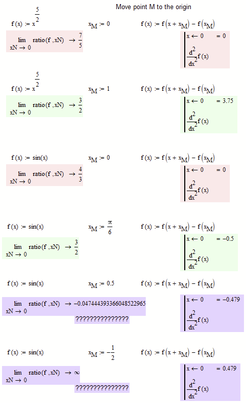

We had this theorem already in a former question of  yours if i remember correct and I already wondered at that time why you marked the question as answered as, so far that I could tell, it wasn't. You wrote there that all is OK now and you just made a minor mistake but I had the impression that you could not arrive at 2/3 with the approach shown. As far as I remember you had the first point a the origin (which was OK IMHO) but you also assumed the second one on the x-axis (which I thought not being OK).
When I glance at the new sheet you posted here, I see, that you still not arrive at that desired value, right?
So maybe a calculation software is not the suitable tool to make a formal, general proof ?

Hab ich da etwas falsch verstanden oder eine (vielleicht im Text nicht genannte) Voraussetzung für den Satz verletzt?
Wo ist da mein Denk- oder Rechenfehler?
The proof in the original paper tacitly assumes that at the edges of the closed interval MN the second derivatives of f(x) are non-zero. This is only apparent at the end of the evidence published by Völler and was not mentioned in the sentence formulated at the time. Otherwise, after differentiating four times under the Bernoulli/L'Hospital rule, nothing could be reduced in the result break. In the case y=x^3 at point M the second derivative is 6*x=0.

OK, diese Zusatzforderung, dass die zweite Ableitung an der betrachteten Stelle (der Grenzwert des Verhältnisses ist ja eine lokale Größe)  nicht verschwinden darf, erklärt die vielen "Gegenbeispiele, die ich fand.
Hab Mathcad versucht zu überreden, das allgemein durchzurechnen, aber bin dann letztlich gescheitert:
Möglicherweise scheitert es daran, dass man Mathcads Symbolik kaum beibringen kann, dass f(0)=0 gilt und dass f''(0) != 0 ist.
Aber immerhin kann man mit dem Blatt den Grenzwert für konkrete Funktionen an jeder beliebigen Stelle x.M ermitteln.
Das Versagen bei den letzten beide Beispielen kann ich mir allerdings nicht wirklich erklären.

The incorrect results in the last two examples are certainly due to Mathcad and the way in which symbolic evaluations are carried out internally.
