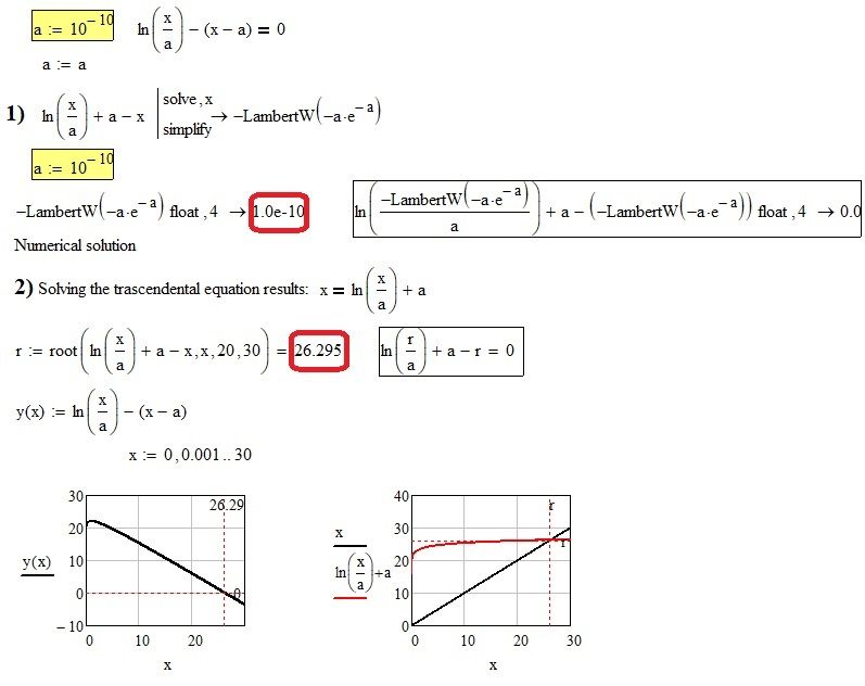

Good morning everyone,
how can I make the calculated value of the symbolic solution coincide with the numerical one of the given transcendent equation? (Imposing with the assumption that 20 <x <30 it falls into an endless loop )

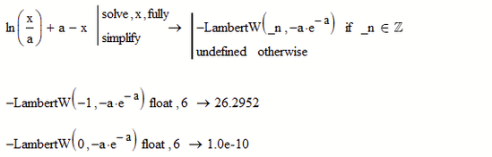

Would this help:
"fully" tries to force the symbolic to give ALL solutions of the equation and Mathcad tells us that we simply have to use all branches of the Labert-W function rather than just branch #0. Most branches gives you non-real results, but _n=-1 gives you the solution you are looking for.

See the following:
Alan

Yup! all clear, but I'm looking for the second root as a function of Lambert ...
(To:-MFra-)
Would this help:
