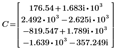

See the enclosed sheet just before the crash.  put an evaluation equal sign after lsolve(A,b) and presto Prime vanishes with no warning or error.

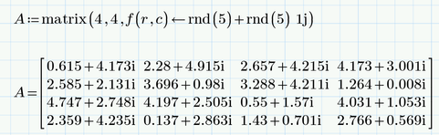

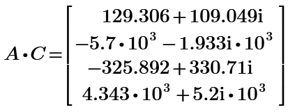

I can't duplicate the error in Prime 6. All works as expected:
BTW, the creation of matrix A could be done easier that way:

Add C:=  no error occurred.
Thanks Werner
looks like a reinstall may fix things.
