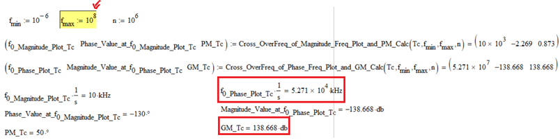

I don't understand why the following thing happens:
The functions I use for calculating Gain Margin (GM) and Phase Margin (PM) are:
The Plant Transfer Function is:
Case 1: fmax = 10e6 => GM_Tc = -22.627 db & f0_Phase_Plot_Tc = 2.471 kHz.
Case 2: fmax = 10e8 => GM_Tc = 138.668 db & f0_Phase_Plot_Tc = 52710 kHz.
Does anyone have any idea what is the reason for this happening in the case of GM?
Calculations and graphs were made in Mathcad 15.
Attached is the Mathcad 15 file with the details.
Thank you.
Best regards.
LucMeekes
(To:Cornel)
The phase of your Tc only dips across the 180° border in a very narrow frequency range, from 1894 Hz to 2795 Hz. The root function that tries to find the crossing needs two endpoints, one on each side of the crossing.
If you stretch your range too far, root will not find any crossing:
It requires a more versatile root finding function to do what you need.

LucMeekes
(To:Cornel)
The 'GM' function calculates the frequency at which the phase crosses -180 deg, using the Lookup function. That is, it tries to find -180 deg in the phase array, and once found, it takes the corresponding frequency.
However, it doesn't accurately search for -180 deg in the phase array. Due to the argument "near" it is satisfied when it finds a phase value near -180 deg, hopefully the nearest value. This means that it will always find a phase 'near' -180 deg, even though the phase never crosses that line.
Note that the 'PM' function also uses the argument "near" to the Lookup function, so you will be able to find a problem there with a transfer function that remains below 0 dB...
As I said earlier, if you want a set of functions for GM and PM that works accurately for any transfer function, you'll need a more equipped set of functions.
Success,
