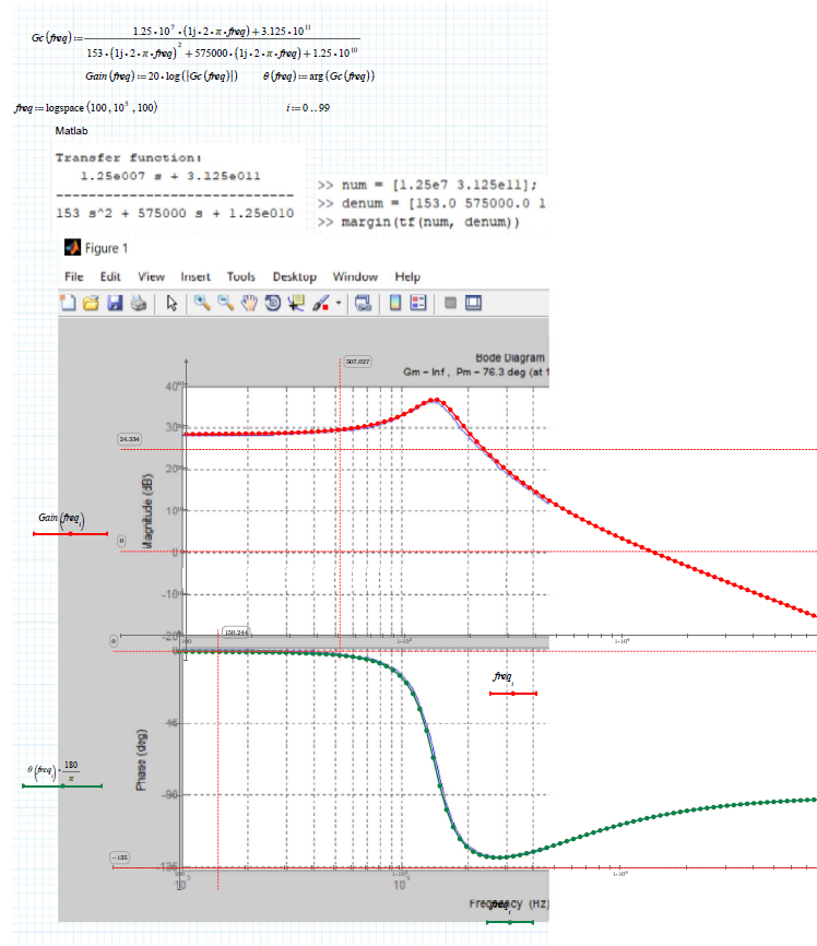

Hello Dear Friends,
How can it be solved that the phase - frequency graph of the bode diagram in Mathcad looks like the phase - frequency graph of the bode diagram in Matlab?
Calculations and graphs were made in Mathcad 15.
Attached is the Mathcad 15 file with the details.
Thank you.
Best regards.

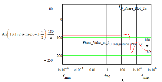

Case 1: fmax = 10e6 => GM_Tc = -22.627 db & f0_Phase_Plot_Tc = 2.471 kHz.
Case 2: fmax = 10e8 => GM_Tc = 138.668 db & f0_Phase_Plot_Tc = 52710 kHz.
Does anyone have any idea what is the reason for this happening in the case of GM?

The phase of your Tc only dips across the 180° border in a very narrow frequency range, from 1894 Hz to 2795 Hz. The root function that tries to find the crossing needs two endpoints, one on each side of the crossing.
If you stretch your range too far, root will not find any crossing:
It requires a more versatile root finding function to do what you need.

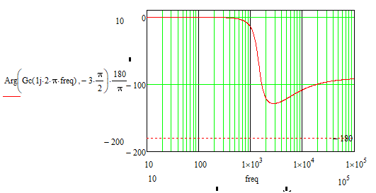

I think there is something wrong with these two functions, how they are built, but I do not know what, at least so "foreshadowed" and I deduce from my more detailed checks by the last resort.

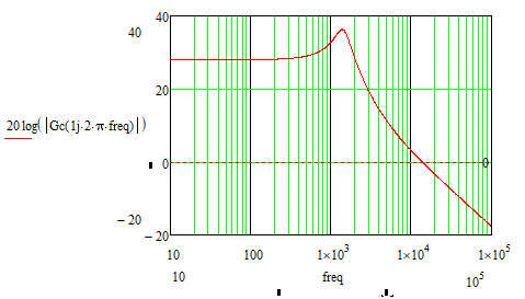

Let's take the following example:
The Plant Transfer Function is:
The axis cutting frequency of 0 decibels on the magnitude-frequency plot gives well, as it results from the function.
The phase-frequency plot does not even cut the axis at -180 degrees so it cannot define a cut-off frequency for this graph, but the function returns a frequency value (this means that the graph cuts the axis at -180 degrees, which is not true).
Reading the value in degrees corresponding to the cutoff frequency read from the magnitude - frequency graph (approximately 13.614kHz) results in a value of -56,259 degrees, which means that the phase margin (PM) is 180 degrees - 56,258 degrees = 123,741 degrees, and the result of the function is -103,666 degrees, and 76,313 degrees, respectively, which is a discrepancy.

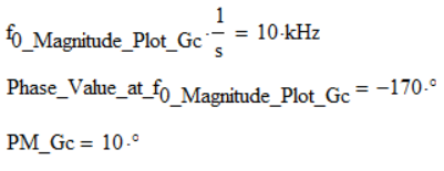

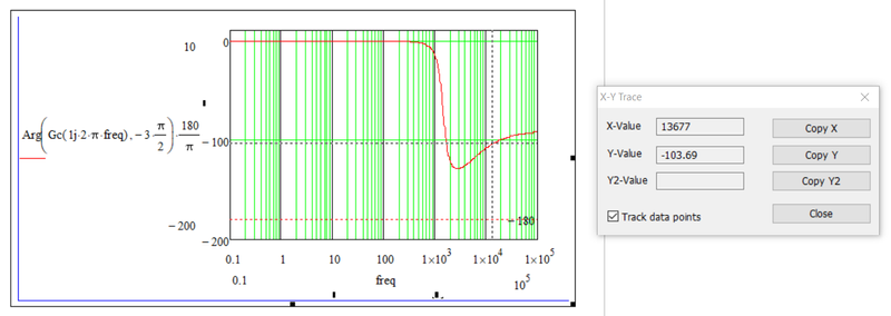

I have a mistake regarding the previous comment:
The Phase Margin (PM) is well calculated with the corresponding function used.
In the previous comment, from the graph, I read at the frequency of approximately 1.3 kHz, but it must be at the frequency of approximately 13 kHz (as much as the cutting frequency at 0 decibels is read from the magnitude-frequency characteristic).
CornelBejan_4-1613766639917.png degree.
But the problem remains in calculating the Gain Margin (GM) with the corresponding function used
This is because the phase-frequency graph does not cut the -180 degree line, which should normally lead to an infinite Gain Margin (GM) (or at least a large value).

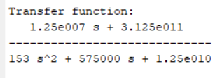

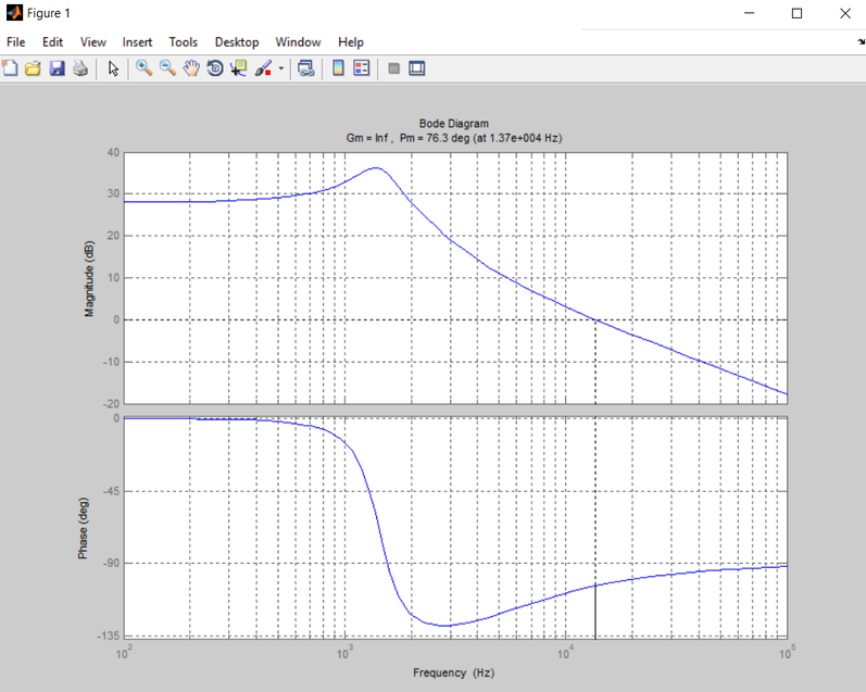

As a check, I put the transfer function corresponding to Gc (s) in Matlab and drew the corresponding bode diagrams.
Mathcad:
Matlab:
Cornel
(To:Cornel)

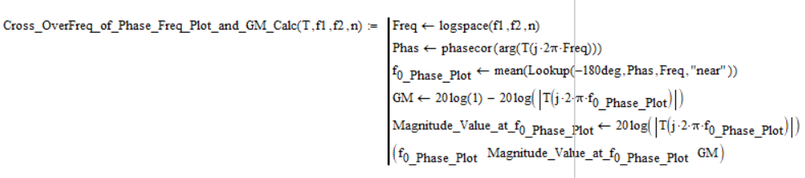

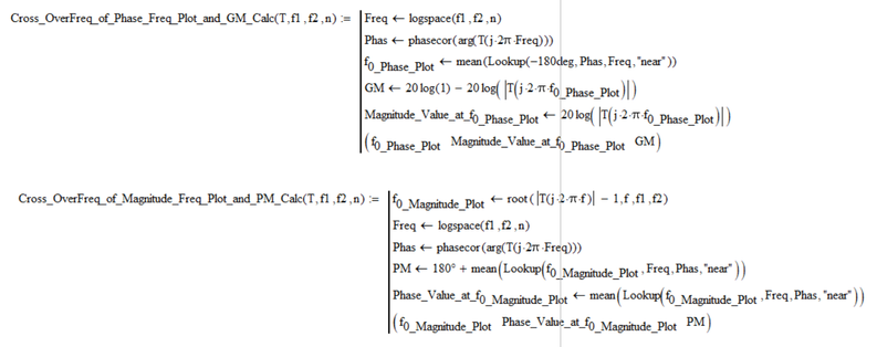

Therefore, the function that I suspect would not have good results is:
Any suggestions/ideas/opinions?
Thank you.
LucMeekes
(To:Cornel)
The 'GM' function calculates the frequency at which the phase crosses -180 deg, using the Lookup function. That is, it tries to find -180 deg in the phase array, and once found, it takes the corresponding frequency.
However, it doesn't accurately search for -180 deg in the phase array. Due to the argument "near" it is satisfied when it finds a phase value near -180 deg, hopefully the nearest value. This means that it will always find a phase 'near' -180 deg, even though the phase never crosses that line.
Note that the 'PM' function also uses the argument "near" to the Lookup function, so you will be able to find a problem there with a transfer function that remains below 0 dB...
As I said earlier, if you want a set of functions for GM and PM that works accurately for any transfer function, you'll need a more equipped set of functions.

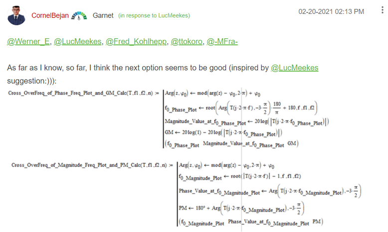

A few more things appear, such as:
1) If the phase-frequency graph does not cut the -180 degree axis then GM should return the value of infinity.
2) If the phase-frequency graph cuts the -180 degree axis by more than one point (2.3, etc., as shown below (*)), then a single point should be extracted or the frequency search range should be narrowed only for a single cut of the graph with the axis of -180 degrees, to get a correct answer.
But it's okay because they keep you awake and attentive to what you're doing, and then they make you not forget how to calculate the Phase Margin (PM) and the Gain Margin (GM) from the graphs when you do not have a computer :).
For example, Matlab takes into account, at least as far as I can see until now, the last point that cuts the -180 degree axis.
For the above completeness in Mathcad:
but as @LucMeekes  says:
Even so, it works well.
