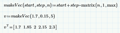

(To:LucMeekes)
Nice idea!
Could be turned into a utility function where you provide start value, step width and number of elements:
