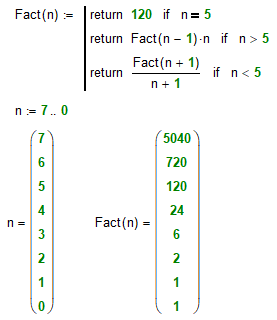

A more elaborate approach would try to find a function (in R or C) with the property f(x+1)=x * f(x) and you quickly end up with the Gamma function
And when you define
you automatically arrive at
So you see its just a matter of how you define n! and mathematicians try to define things so that the definition meets their needs, clever, isn't it 😉

In Math often things are not that easy as they may look on first sight.
The examples with negative numbers you give clearly show this.
According to your definition n! := n* (n-1)! with 1! := 1 as an anchor, it would be 0!=0*(-1)! and therefore (-1)!=0!/0=1/0 ... Oooops!!
Actually Gamma(x) is not defined for x=0,-1,-2,.... it has poles there. This is the reason why n! is defined only for the members n of the natural numbers (which accodring to the current standards include 0) and not for negative integers.
But no fear - your Mathcad is fully correct, because you typed -1!=1 (which is a correct result) whereas you wanted to see (-1)! =  which is undefined and I am pretty sure that MC11 knows that, too 😉
