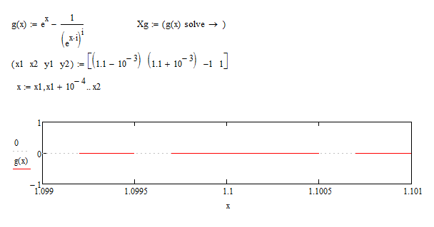

Hello Everyone.
From:
https://www.wolframalpha.com/input/?i=solve+e%5E(x)-1%2F(e%5E(x*i))%5Ei)%3D0
The question : How many solutions does the g(x) could have ?
Thanks in advance.
Regards.
Loi.
Solved! Go to Solution.
Whats your problem?
I have no problem. By the way from the below, how to make a correction ? Regards.
@lvl107 wrote:
Oh..., so far I propose one :
Best Regards.

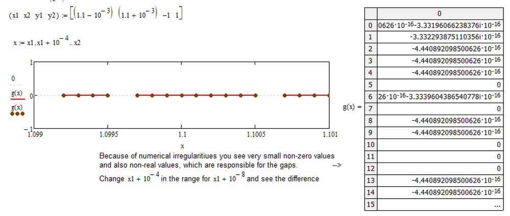

How much accuracy do you expect from numbers stored in IEEE format. You run into numerical inaccuracies.
See the changed picture in my post here https://community.ptc.com/t5/PTC-Mathcad/Does-anybody-think-that-Wolfram-is-correct-with-this/m-p/579535/highlight/true#M183155
Don't use the assignment ":=" but the evaluation "="
