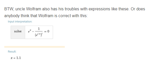

Does anybody think that Wolfram is correct with this ?
lvl107
20-Turquoise
Hello Everyone.
From:
A.PNGA1.PNGhttps://www.wolframalpha.com/input/?i=solve+e%5E(x)-1%2F(e%5E(x*i))%5Ei)%3D0
The question : How many solutions does the g(x) could have ?
Thanks in advance.
Regards.
Loi.

Oh..., so far I propose one :
C.PNGBest Regards.
C.PNGBest Regards.

How much accuracy do you expect from numbers stored in IEEE format. You run into numerical inaccuracies.
See the changed picture in my post here https://community.ptc.com/t5/PTC-Mathcad/Does-anybody-think-that-Wolfram-is-correct-with-this/m-p/579535/highlight/true#M183155
