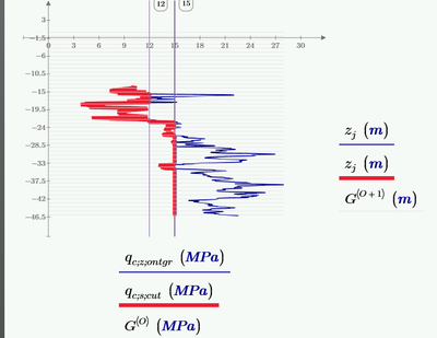

Hi there
It has been days since I started working in this task , but couldn't reach the right result

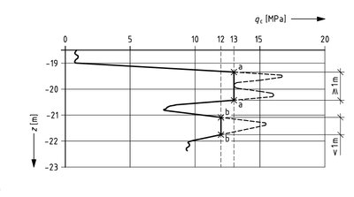

I need to draw this graph in mathcad
I have two values >>
z ( depth a reading taking each 0.02 m )  so in one meter we have 50 z-values
and qc ( resistance in that  z depth)
I need to write a program that will choose the minimum values of ( q , 12 MPa ) if  change through z depth in one meter is less than 12MPa
and the minimum value of of ( q , 15 MPa ) if the change through one meter is bigger than 12 MPa
the sheet is attached

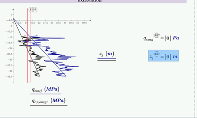

What does this mean?
What's the exact algorithm?

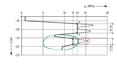

What should happen, if the red distance is larger than 1 meter, but the green is less than 1 meter?? Is the limit 12 or 15?? And why is it that way?
What, if there is part of the curve between 12 and 15 in this case (drawn in blue)?

Let say the whole depth is 30 meters and z is a reading taking each 0.02 m for qc ... so I want to check the values in each one meter (1 m)  so I will be checking 50 values in each step .
1) We consider 1 meter as a constant height  to check the values
First  : I will see the values in one meter if they are bigger than 12 MPa , than choose the minimum value between ( qc and 15 MPa)  not the 12MPa ... it may be 13MPa or 14MPa
Second : if the values are equal  smaller than 12 MPa than choose the minimum value (qc, 12 MPa )
for this question: What, if there is part of the curve between 12 and 15 in this case (drawn in blue)? choose the same value ( not 12 MPa and not 15 MPa ) if it is 13 MPa so it will be 13 MPa
I hope this makes it clear

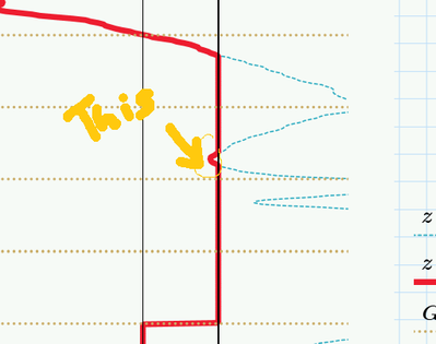

Here the first 5 meter

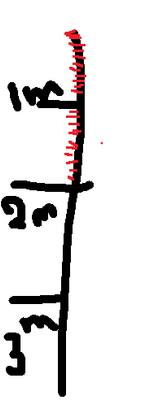

Okay
like this ... in each 1 m , I have 50 readings ( the red lines )
I want to check these 50 values in each one meter separately... so for 30 meters I will be checking 1500 values but each 50 values separate
the limit should be always 15 MPa .. so if qc is bigger than 15 MPa it will choose 15 MPa
if (all *) the values in that 1 m are between 12 MPa and 15 MPa , so they will remain the same ( notice all of them ) i
if all the values in that one meter is less than 12 MPa than it remains the same ... but let's say 20 values from the 50 values are bigger than 12 MPa and the rest are smaller  so in this case it will change the big ones to 12 MPa.
I know it looks crazy but usually in one meter the values can't decreases rapidly...

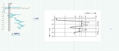

Somehow, I also get the impression that your descriptions do not match the drawing you attached at all.
Why would that one area be limited to only 12 MPa, even though there are values in this 1-meter interval that are greater than 13 and also greater than 15 MPa (Guess you replaced the 13 MPa in the drawing for 15 MPa in your explanations)
The drawing somehow suggests that the limitation to 12 MPa is due to the fact that the area in which 12 MPa is exceeded is less than 1 meter. But that does not fit in with your description at all, in which you always want to examine an interval of exactly 1 meter.
May we consider this drawing as irrelevant?
You are totally right by what you say , however this code suggests the layer thickness to be related ( can be thicker or thinner than 1 m)  which needs soil test in reality every time you want to implement this condition which can't be done easily ... this is why we assume that the values in one meter should be near to each other and represent a layer regardless if the layer thicker than one meter or thinner ,... If thicker it will divide it and do the same to next group which is okay .. if thinner it will limit the values

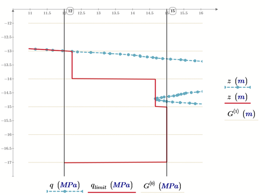

(To:YA_10963798)
@YA_10963798 wrote:
Thank you Werner .  Can we do one last thing?
Can we add this to the program
if  12MPa < qc < 15 MPa choose the minimum value from all the 50 values
I sincerely hope that you don't mean what you are writing. I hope you don't mean "qc" but rather mean the minimum of all 50 q-values within this meter, correct?
So the only criterion still would be just the minimum value of all 50 values, no matter what the other values are?
The logic now is:
If this minimum is smaller than 12 MPa, limit all values to 12 MPa
If this minimum is between 12 and 15 MPa, limit all values to this minimum
And otherwise (minimum is larger than 15 MPa) limit all 50 values to 15 MPa.
See attached both functions modified accordingly.
As you can see this logic not only affects the values in -15m..-14m but also the ones in -14 m to -13 m.
(I added points in the plots of the original q-values yo you see which q-values triggers (is the minimum))

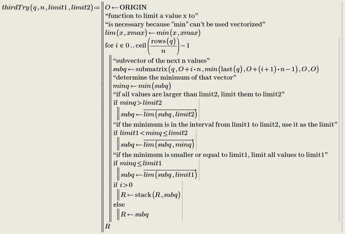

(To:YA_10963798)
@YA_10963798 wrote:
That's exactly what I meant . Thanks a lot
Fine!
Here is a version using a series of stacked if-statements rather than the nested if-functions or any 'else' or 'elseif'.
I think its clearer and better documented that way what the underlying algorithm used is.
