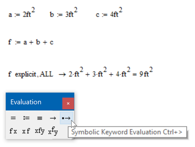

This should be simple.  I have an issue where I define an equation and get a useful result.  But further down in the mathcad sheet I just need to echo the equation that defines the variable to the user so he can make other determinations from the equation.  How do I do that?  See attached.
I need the means to do this in Mathcad 15 and in Prime 8.0.

In (real) Mathcad, like this:

From help page of explicit.
5.To perform the above numeric calculation without using explicit, use the clear.sym function to clear the symbolic values of all variables:
6.Use explicit to display formulas in terms of variables, without substituting values for the variables defined elsewhere in the worksheet:

Mathcad 15:
In MC15 you can hide the keywords and make the arrow look like a normal equal sign

In (real) Mathcad you cannot have the symbolic keywords above the arrow, that is a feature introduced in Prime.
Do you mean like this?
  • Copy the equation, paste below..
  • delete the trailing evaluation " ="
  • REPLACE the defining " := " with the boolean comparison equal " "
Works in any Mathcad.
No success yet.  See attached.  Maybe there is a default in Mathcad 15 that needs to be set?
(To:Snowshoeman)
Hope this helps:
MC15 file attached
You are amazing!  I had given up on this.  I had figured out some work arounds but the workarounds required that I change the company template.  That wasn't palatable for the rest of the people in my group.
Thank you!
