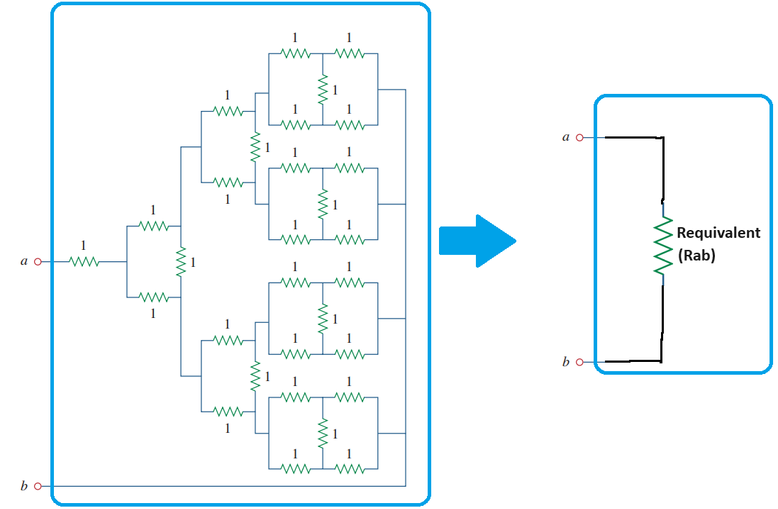

Find the equivalent resistance between a and b port (Rab (=Requivalent)) for the bellow circuit. Assume each element is 1 ohm.

V=I*R. 1A current is applied to node a to b. Therefore, Va=Rab. Nodal voltage method is used.
Gii is the number of resistances connect to node i. Gii=3 means node i has 3 resistances. Gij is -1 when between node i to j has resistance
1/1 ohm = 1 S, so conductance = number of resistance

Cornel
(To:ttokoro)
That's correct, 2R!
