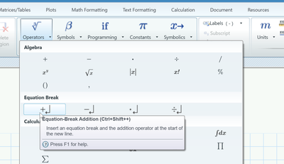

The possibilities of equation breaking are limited - its only available when inputting an expression, not for the output/evaluations of results.
The keyboard shortcuts have changed going from from Mathcad to Prime - so Ctrl-Enter isn't doing the job anymore. Equation breaks are now allowed for any of the four basic arithmetic operations and the shortcuts are Ctrl-Shift-+, etc.
See also the help info
https://support.ptc.com/help/mathcad/r9.0/en/index.html#page/PTC_Mathcad_Help/keyboard_shortcuts_for_equation_break_operators.html
https://support.ptc.com/help/mathcad/r9.0/en/#page/PTC_Mathcad_Help/about_equation_breaking.html#

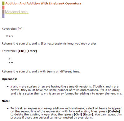

We are able to break equations in Mathcad 15 (but only with addition "+"):
Yes, thats what I wrote in my first answer in this thread where I pointed out that in Prime the keyboard shortcuts have changed because line breaks can be done for all basic arithmetic operations now.
