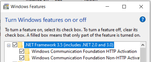

I am having a similar issue. I have Mathcad 15 installed and licensed, and I'm trying to convert a worksheet using Prime 7.0 converter.  The error says it cannot start the converter - check if .net 3.5 is enabled, which it is.
I really don't see how uploading a worksheet for someone else to convert is an accepted solution.  I can't share my file.
VladimirN
(To:jstone-2)
Verify that .Net Framework 3.5 Windows feature is enabled:
  • Open Control panel > Programs and Features > Turn Windows Features on or off,
  • Ensure all the checkboxes are checked as below.
jstone-2
(To:VladimirN)
