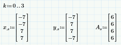

I'm trying to create a mathcad code for analysis of RC sections but I'm getting this problem.
It was supposed that the vector esk was 10e-5 in all elements, but some in some terms I'm getting 4x1 when was supposed to be 0, how can i solve it?
My code is in annex if someone wants.
You defined xs, ys, As with subscript k meaning each element was a 4x1 matrix.  Define them like this without the subscript k in the definition. Cheers
thanks bro, it worked well
