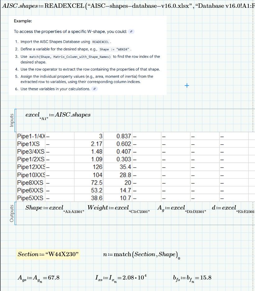

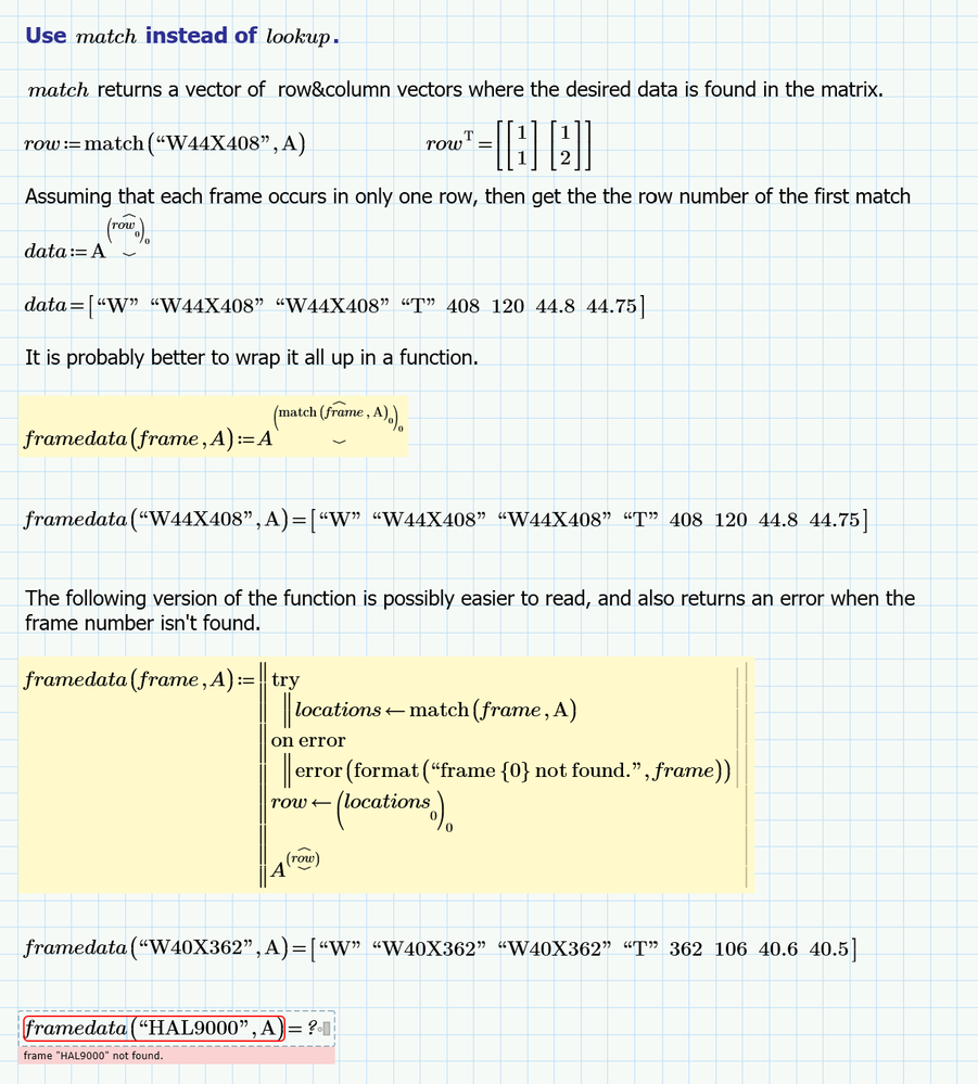

I have the excel in that some type are there for e.g. frame size and its W,A etc. is there, I am trying to create this in Mathcad when I type the frame name it will automatically shows the all parameters related to that how this is possible in Mathcad for this I am using lookup function if anyone done this in past or have any suggestion how to achieve this pls comment on this I also attached the sheet and excel file.

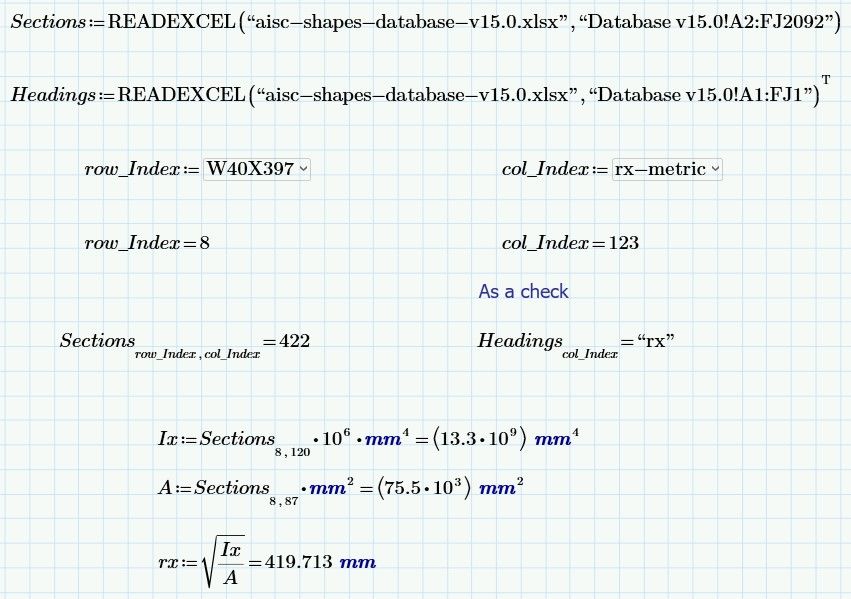

For the entire AISC database both imperial and metric I use the following:
Select the section and the column of a variable then assign it below for use in calculations.
You can check the assigned value against the row and column value each time.
See files 220618-Sections Option 3 and database version 15. for above.
Alternately a poster to the community did this.
see AISC v16 sheet and excel for above
Cheers
Terry
Sorry.  I thought I had attached the worksheet.  As I said, it's Mathcad Prime 11.
Stuart
