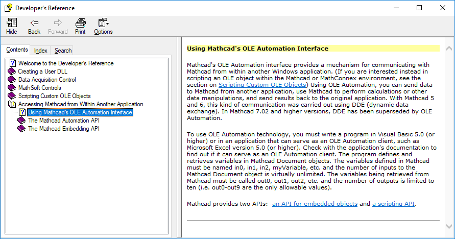

Have a look at your Mathcad application Help menu, in the section "Accessing Mathcad from within another application" you should find something like:
Hi Luc - thanks for the link I've managed to figure out the MathCAD help article and got a rough version of what i want out of it. So thanks for pointing me in this direction!
