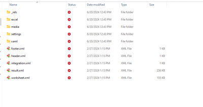

I did what you suggested but the worksheet file does not WORK. other files work . why do you think that happens?
LucMeekes
(To:YA_10963798)
The error message you show is clearly not from Prime.
What worked yesterday (ref: "thank you so much it works") and what does "not WORK" today while "other files work"?
What did you expect to get out of the .xml worksheet file?

What works is the way you showed me to convert the sheet into xml files.
What doesn't work is only one file ( named as worksheet) please check the image. all the other files open and have data on.
LucMeekes
(To:YA_10963798)
The .mcdx file usually contains the calculation results, but not in the worksheet.xml subfile.

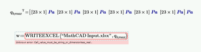

ok thank you for that information, I tried but this error occurs
(To:YA_10963798)
You have to strip the units (divide by them) as Excel can't deal with units.
You can't export a nested array - how should Excel arrange the data in its 2D spreadsheet?
You have a 6x1^matrix containing 23x1 matrixes. You may create a 6 x 23 matrix or a 23 x 6 matrix from your data, strip the units and then export it to Excel.

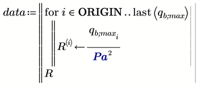

Strange enough is that your quantities are of unit square of Pascal!? Not sure how you managed to create that data structure!? I tried and I could not create it in a way the Pa would be shown for each vector and also at the end.
Anyway, you could try something like
which creates a simple 23 x 6 data matrix of unit-less scalars which then could be exported to Excel.
