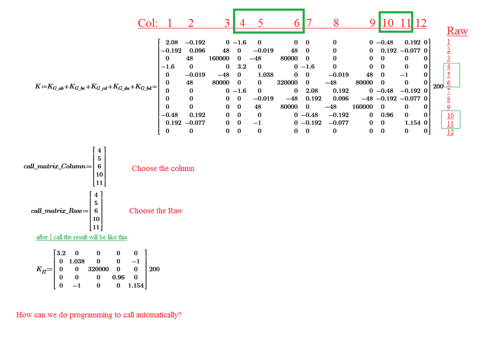

Dear all
I try to extract matrices by Column and Raw Input as pic attachment.
please help me
thank you.
(To:SPRstructur)

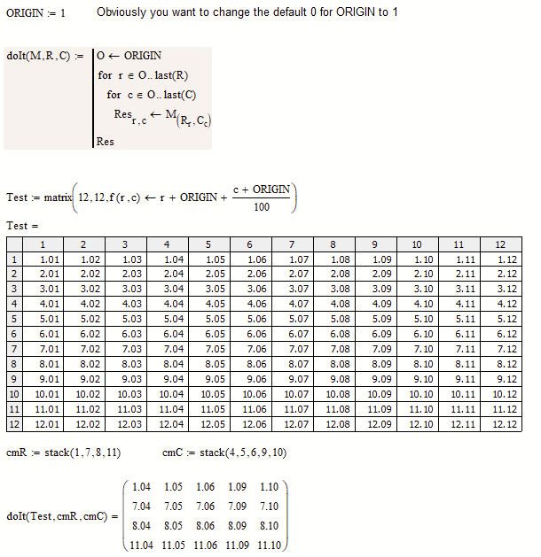

Here is one possible approach:
MC15 sheet attached
MC15 sheet attached

Many thank
It work well after I convert to Prime
